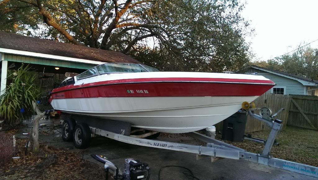

I recently bought a 1989 chaparral villain and it wouldn't start unless you sprayed carb cleaner in it. It had some bad wiring so I started splicing them back and I got it to start. Wouldn't rev over 2200rpm without studdering and back firing, so I put in new plug wires, pumped out 50 gallons of bad fuel and cleaned the gas tank,also put in new water separator. no difference. Put in a new ignition module and it ran better but not great. Put it in the water and it just Boggs under a load. Just starts missing and backfiring but every once and a while it'll start to pick up (actually plained ones for a second) so before I start pulling injectors I figured I'd ask you guys. Ive been doing research and it says it has a limp mode where it'll only get 2500 rpm,but wouldn't it be a smothe 2500 and not missing?

Your first post said 1989 and now you say 1999. Can you take a picture of what you are working on and also get us a model number?

The motor is around a 99 boat is a 89,where can I find the model number?
51,365
Re: volvo penta 7.4 gi runs bad
need pics of the motor.
a serial number would be best.
something is not adding up.
