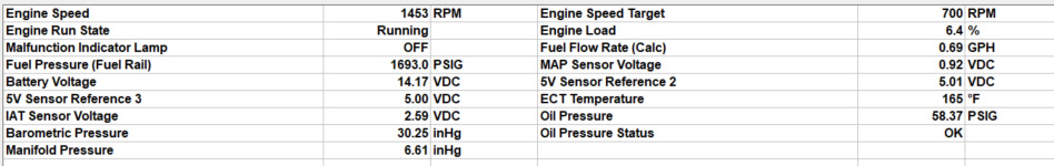

At this point I'm thinking there is math inside the ECM that determines the output for the Fuel Rail Pump signal to the high pressure pump. That math is made up of information from 7 (I think) sensors. Looking at all of them with the Diacom software, only the ECT and Oil Pressure sensors seemed a little off. So I replaced them. Signals look better, but still no codes, still same issue.
