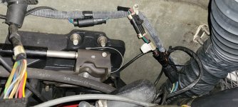

I have a 2007 Larson 228 LXI with a Volvo Penta 5.0 GXI-G/SX-A. The Trim does not engage, I have checked the switch, no power to the switch. I traced the wire back to where it goes through the hull to the pump on the outside and there appears to be a "Inline Fuse Link"? I honestly have no idea what it would be called. Unplugged all the connections and tested it is not getting power on any side of the connection. Does the trim switch need to be engaged to allow power through? I was not able to find a fuse block on this boat.
Any thoughts/suggestions/wiring diagram are appreciated.
Thanks

Trim switch is what energizes the relays which then sends power to the pump
Check breaker and fuse
