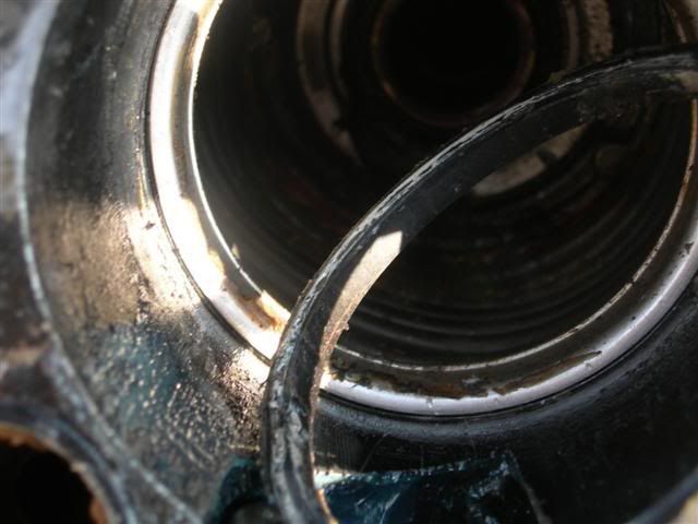

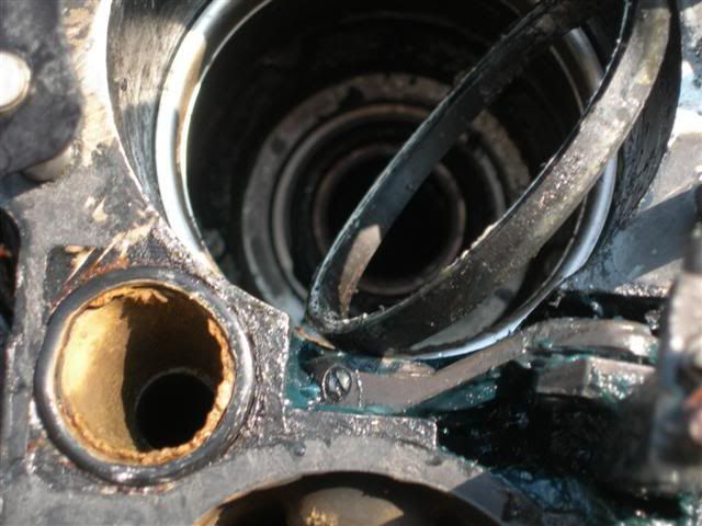

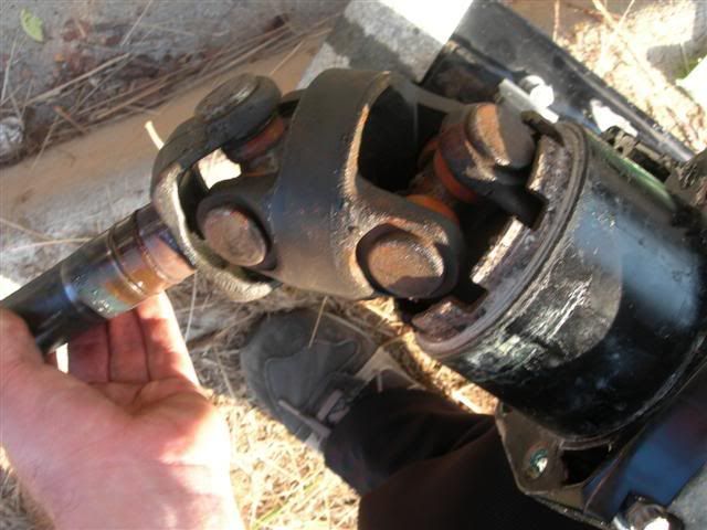

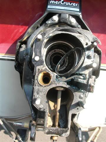

Ok so I took off the rest of the drive this morning. After the usual struggle, I finally got it off. A bit of water came out and there is a bit of brown sludge in the top bellow. The bottom one (exhaust?) appears fine. The bell housing gasket was half missing, and the water inlet oring looked as if it could be leaking. Hopefully this is the cause of my problems?
Heres some pictures I took tell me what you think. Turning the u-joint seemed smooth with no play in it.

Re: Water in gear lube monitor
Not good!......:(
The water inlet won't do that....
Either your ujoint bellows is bad or the large o ring was improperly placed when the drive was installed.......
You will need to drain & pressure test the drive like Don S said....
If you are lucky, it will pass.....
If there is no gear lube in the bellows, the yoke seal is still good, but it should probably be replaced & the yoke inspected....
I'd pump the ujoints & gimbal bearing with grease to get out any residual water.......
They may or may not be OK, but from the looks of them, (rust) they should be replaced.......
Inspect the ujoint bellows closely, it is the most likely suspect, but the large oring looks funky......
The exhaust bellows have no part in this situation either.....;)
