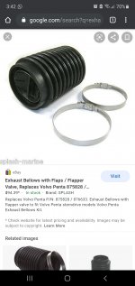

Do you think i can try this??
Lou C
Nov 10, 2002
13,064
nope that's for a Volvo Penta AQ set up. You need the OMC ones, the parts are still available so order up the flappers, pins and grommets.
50,313
not only is it for an AQ series. its not designed by volvo, not needed on a volvo (they have an external flap) and they are made in china
