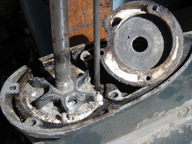

I need advice on removing this pump housing. Screw head all broke off near the top. Corrosion is evident.
Do I:Break the pump house to get to the screws stubs or is there some trick I can try? The pump housing is no longer available through factories... I think?
Any ideas?

The pump housing looks like it may have pitting inside. If that's the case, the housing is expendable. Looks like it's been a really long time since anyone's been there. Make sure to coat the screws with gasket cement. You'll proabably need a machine shop to get the screw remains out.

Yes...It looked pretty corroded inside. Where would I pick another housing from? Is there a later model part number that would do the job?

I hit it with the hammer. It didn't do too much damage. Just the water outlet crushed a little. As you can see there is a bit of crust in there.

WOW thats nasty !!!!
i was gonna suggest drilling 2 5/32" holes in the top of the housing and running two 1-1/2"x10-32 screws in the holes using the wear plate to push it off of the broken screws - i did this on my fastwin because i knew the housing was toast anyways worked GREAT!! just ruins the housing

What's the rest of the mtr look like, meaning p/h cooling passages and ect? That's the worst one I've seen in a long time.
