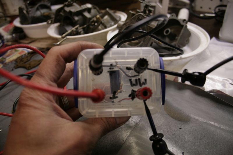

I made a bottom-feeder DVA this afternoon and decided to play with it a bit (at this point, Mrs. BlueFin16 gave me the 10min warning so that my daughter can get her beauty-sleep).
I went ahead and checked the charge coils with it; I'm reading +300V...well within spec (150-400V)
I started to check the trigger coils (while connected to the old powerpack) and was only getting ~5V...and the Admiral shut-down the operation; now I have all evening to ponder this result :lol:
