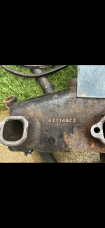

I’ve got a similar question, regarding exhaust manifold compatibility:
I have a 1981 Sea Ray SRV 195 with The Mercruiser Serial Number 5849269.
The exhaust manifolds I am replacing have the numbers 87114 BC2 stamped on them.
I’ve noticed that many mercruiser exhaust manifolds have a time period (1983-2002) connected to them. Would manifolds with this time period compatibility suffice with my engine?
I’m having difficulty finding exhaust manifold replacements for my 1978-1982 manufactured engine.
Thank You!
