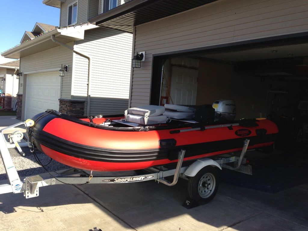

Here she is rigged 'n ready for fishing w/my lad in the morning.
Bow mount troller goes on w/unique mod next week...
