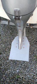

I have these two things on my boat to aid with trimming .
The transom wedges give you more trim in and the other thing is a permatrim which is made in NZ so maybe not available in USA but there are others similar . Some say ( here they come 😁) you dont need them but I had one on my previous boat and took it off to see what happened and I could not stop porpoising so it went back on . That boat was overpowered ( read motor was to heavy ) and it worked a treat . To be fair it didnt make much difference on this boat but it is underpowered ( needs a 70hp 2 stroke but has a 35hp 4 stroke ...which weighs about the same as a 70hp 2 stroke ) .
Your boat sounds to be suffering from to much weight at the back . Built in tank ...your right ...cant be shifted . If that were my boat I wouldnt hesitate to fit a similar cav plate extension as it will give you more lift .

View attachment 417413View attachment 417414
Yeah I have been researching all night and found multiple posts from people with similar boats having the exact same issue with the conclusion that the 4 stroke motors are just to heavy.. this is an earlier osprey so I think it weighs 960lbs so full of gas and motor is over half the weight.
The motor has a similar tail on it already and it didnt help.
