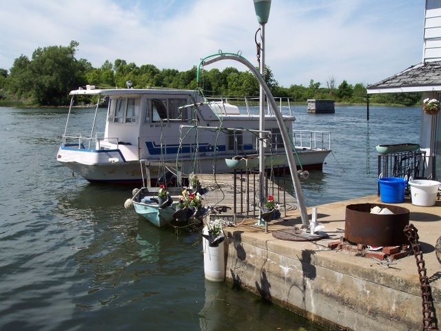

Here is my boat.

Ayuh,.... Cool barge,....
If this photobucket fix/ patch works, Mine should be just below this text,....
