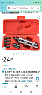

Not so much creaking/groaning. People seem to think air or water is making the noise. Still trying to find time/light to open the screw and inspect what fluid to get. I sprayed some WD-40 on it and let it sit. Need a chisel or some other sort of tool. Widest screw driver I have is not wide enough and I'm afraid of stripping the nut.

You need an impact driver.

Most of my tuff bolts-screws etc..... have come out easy using a 1/4 impact driver ...starting at the lowest setting. adapters are available to mount 1/4, 3/8, 1/2 inch sockets .
Dollar store adapters for $4 CDN a kit have proven very reliable for home (non-commercial) application with my Craftsman sockets and screw adapters for flat, philips, square & torx
