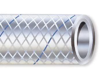

Oops, when you speak of a braided line are you talking about something with a barbed fitting and hose clamps ?

Re: What type of line to use to replumb fresh water system
think hes talking about something like this
when searching for water hose, be sure to specify "potable" because the non potable stuff would make it taste really bad!
