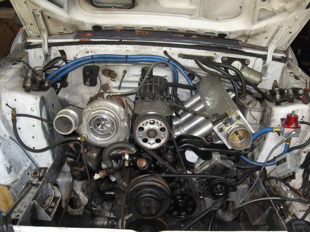

I've got 3 shortblocks sitting in the garage. I'm in Ky if you can find a way to get them. One is a regular auto block and the other 2 are turbo blocks. You'd have to plug the turbo oil return in the block but the turbo blocks are thicker in the cylinder walls. I play with 2.3 turbos. 2 of them would need to be bored. One is usable as is and has the factory forged pistons and turbo rods. We've made over 400hp on the stock bottom end so I think it'd handle a boat alright.

very cool pic :)
