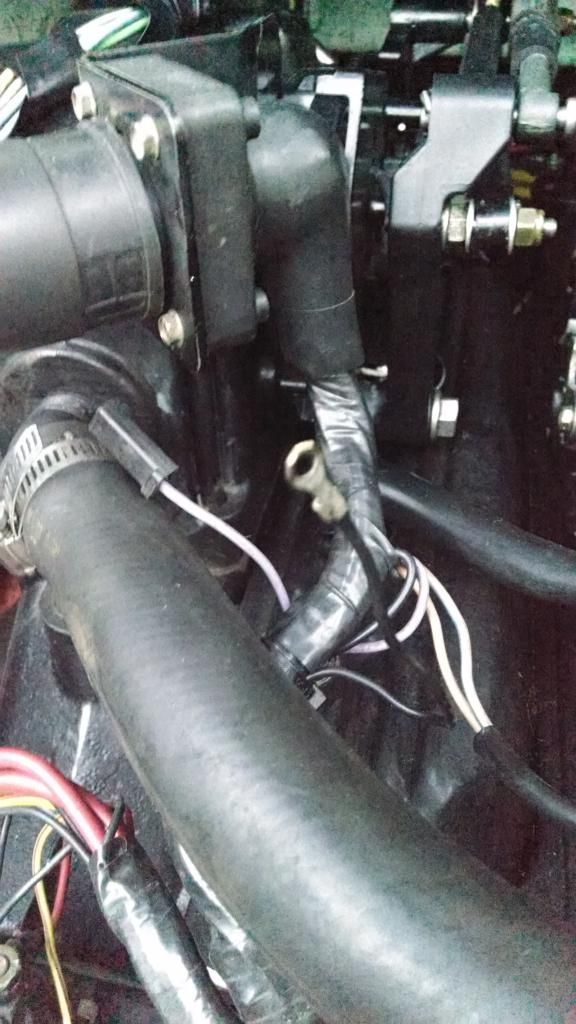

1993 4.3LX The black appears to be a ground but the purple is not. Any ideas where it goes?
M mtsumedi Petty Officer 2nd Class Joined Jun 2, 2006 Messages 109 Jul 9, 2014 #1 1993 4.3LX The black appears to be a ground but the purple is not. Any ideas where it goes?

M mtsumedi Petty Officer 2nd Class Joined Jun 2, 2006 Messages 109 Jul 9, 2014 #3 No Title I thought this picture was uploaded the first time.
M mtsumedi Petty Officer 2nd Class Joined Jun 2, 2006 Messages 109 Jul 9, 2014 #4 No Title Third time's a charm?
oldjeep Admiral Joined May 17, 2010 Messages 6,455 Jul 9, 2014 #5 After you upload make sure to hit one of the buttons that indicates the size of the image you want to insert. Makes no sense at all, but that is how it works
alldodge Moderator Staff member Joined Mar 8, 2009 Messages 42,623 Jul 9, 2014 #6 The purple wire goes hot when the key is turned to run or ON
Bt Doctur Supreme Mariner Joined Aug 29, 2004 Messages 19,348 Jul 9, 2014 #8 now there a pic, I`m guessing they go to the choke heating element
