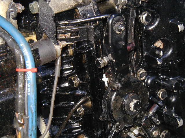

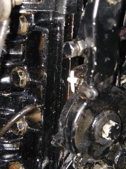

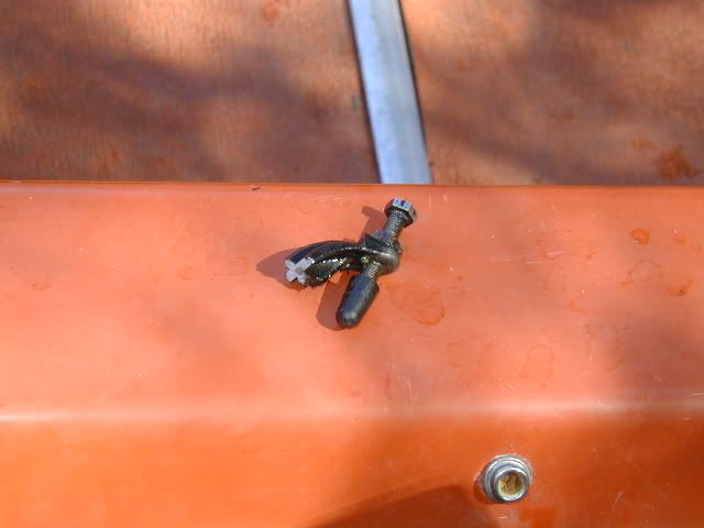

ok I think I just fucked myself over guys, I tried to adjust the throttle screw and it didn't do anything, I loosened it up and the throttle woudn't go any lower, so I tryed adjusting the throttle cable a couple turns then went and move the throttle a bit to see if it would seat itself and then I heard a POP and this piece broke off(pics below)...have I fucked myself and engine? i was thinking if not to much presure is on this piece I could us a little JB weld....I don't have much money to spare and really need the boat to work next week :'(

Take the arm off the engine, take the two parts to a local fabricator that can work with cast aluminum. It can be welded. When you have it installed again. Follow my instructions on setting the idle and leave the cable disconnected. As I mentioned, the cable is NOT to be adjusted for idle speed. Its a length adjustment. If you adjust the cable for more travel in one direction you lessen the travel in the other and end up doing what you did.
