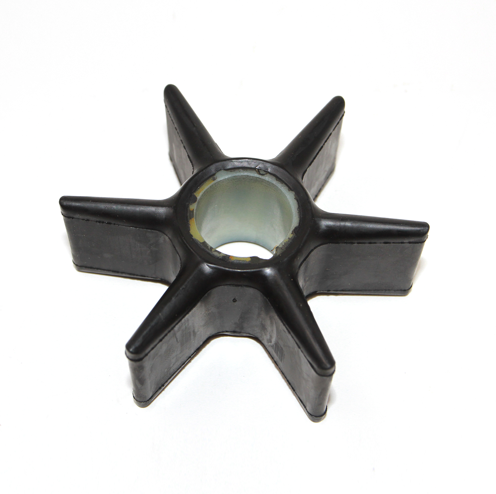

Another difference between the two kits I bought, one impeller had a plastic core, the other had a metal core. Im leaning towards the metal core.
