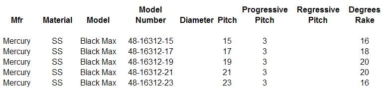

I don't have the blade geometry specs on the NEW Black Max, but I do have the specifications on the older Black Max Stainless.
I will post some differences so you can see why your dealer is mystified by why it didn't do what he thought it should do. And I will tell you why EVERYONE is mystified at times by what should happen and doesn't. There are other props on the market that show much more dramatic differences between one pitch and another in the same make and model of prop. The Bravo II changes from a progressive pitch of 3" and a parabolic rake of 8 degrees from its lowest pitch to a progressive pitch of 4" and a parabolic rake of 15 degrees to its highest pitch props, and that is in just one make and model of prop.
We will find this more and more common the future in my opinion, and that is why an Enertia in the lower pitches will push a good sized boat very well but in the higher pitches it is useless for larger boats.
Black Max Prop Specs
In the old days you would NEVER see this, only a change in Diameter and Pitches. But as they scientifically design the newer props they are absolutely taking advantage of all their new found knowledge of how props work and what happens when you change pitches to try and keep them doing what they want it to do, but sometimes they make errors. And it sure does make for some unexpected surprises for somebody who needs to change pitch in the same make and model of prop.
Lou you may find a new 19" pitch will only lose 1 or 2 MPH. and that is the way it should have worked, your dealer was right in his numbers. If it doesn't you will need to change the model of prop you are going to use. Those props are hand finished and the prop just may been messed up in the process of the pour and the finishing.
