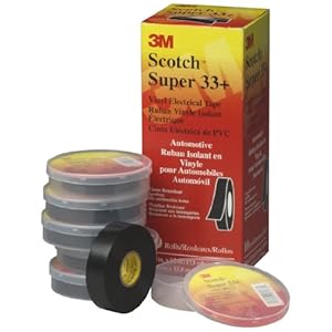

Good ole 33 is the best. Only stuff I use. As stated, you get what you pay for. Compare a 33 role to a econo brand. You will find the core to be small which equals more on the roll of 33 vs a larger core on the econo brand. I find wrapping it tight makes it hard for it to unwrap.

My local Wal-Mart sells Small rolls of the 3M 33. It's pricey,especially for the amount you get, but a lifesaver at 8pm on a sunday...
3M also has a lower quality stuff that needs to be avoided as well...but the 33+ is where it's at....

I am in for the 33 or 35 fan club. Nothin else, ever.

+1 for 3m 33.

Super 88 is good too and is about a hair thicker than Super 33+.
The small core means quality. I looked at some junky big core Scotch at work today and its marked "700". ABSOLUTE RUBBISH.
