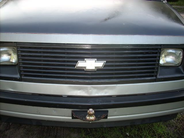

i think you are far over thinking this situation. i solved my same problem for $50.00. just had my friendly welder make this and bolted it to the front end. they also make a reciever hitch that mount on the front. makes moving any trailer simple and easy.
