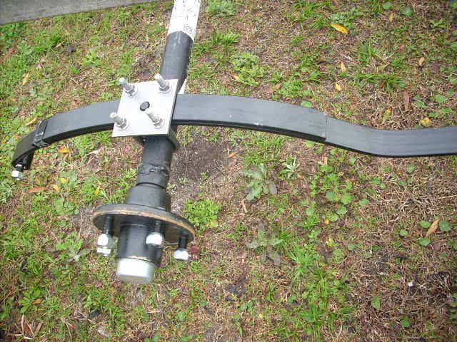

order 2,000lb under carriage, came complete with lug nuts, bearings packed. took 15 minutes to assemble. cut 2 bolts on trailer, and just slide this one in, and tighten spring mount bolts. $180.00 Delivered Texas to Fl, etrailerpart.com. old pics first, and it rained last night.

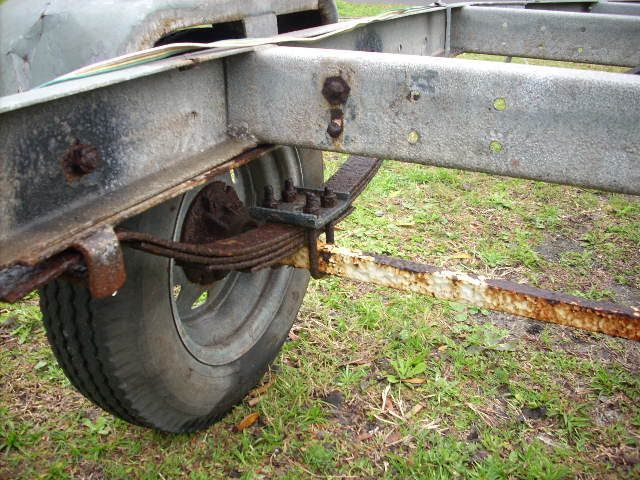

4 inch frame 50 year old galvanized trailer, not destined to be a construction trailer. it was a salt water trailer.

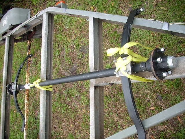

i'm just going to flip this thing over, cut the 2 bolts, and in it goes, flip it back and start on the flat bed.

the axle is shot. too many years of the previous owner running it without grease caps, and salt water. the axle nut is rusted on.

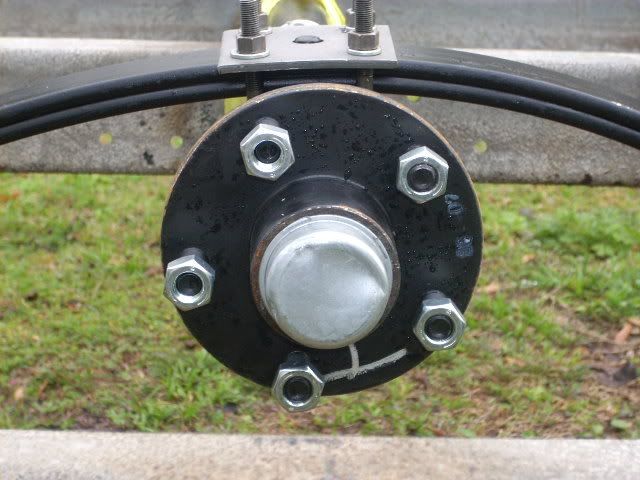

installation took about 30 minutes including new lights. ready for the flat bed to be put on. took longer to cut the old parts off, than to install.

just cut each side of the mount bolt, and the undercarriage slide out, new one slides in. 2 bolts to mount it. to mount the springs, find center of the axle, then measure out from there. set it up as in the picture, block the axle up the the spring, install ubolts.
