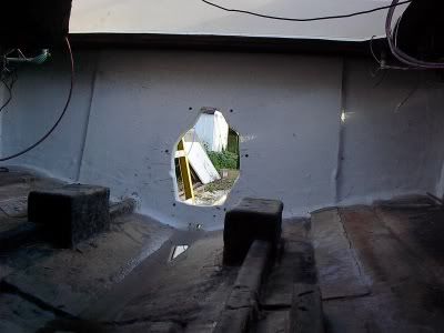

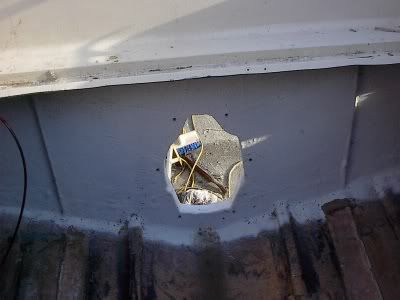

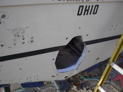

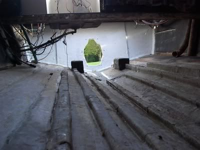

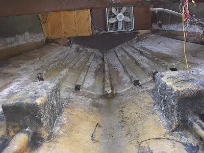

Trying my best to aquire energy to get-r-done, I have managed to get the transom in. A night of long necks after a hard day/nights work, my trusty chainsaw went wild and wouldn't stop at the transom. Yeah, it opened up more cans of worms than I wanted. There were 2 stringers that I didn't replace 5 years ago and thought I might as well do them now. Douglas Fir on order and waiting for it to come in. Normally it would have been here in a week, but with the gas prices up, the shippers are now waiting for a full load before sending. Now that just makes me want to cry! <br /><br />Saturday I started grinding down all the hull glass on the inside. Found that using a knotted wire brush really does a great job on a mini grinder. Took me about 7 hours. At least I'm ready for my wood that is not here.
<br /><br />Here are some pics of my progress so far. The Gorilla glue worked excellent for glueing in the wood for the transom. Painted it white vs black. Why do they paint bilge areas black? What were they thinking? <br />
