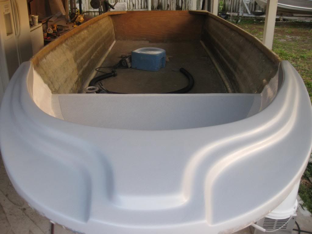

First thought ,first pic ... What is she doing to the golf cart ? :lol:

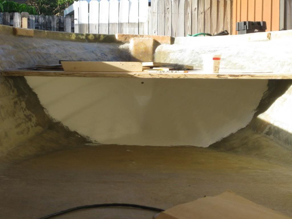

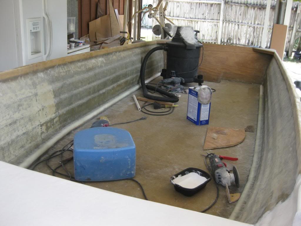

Pic 2 and 3 ... Nice work as usual !

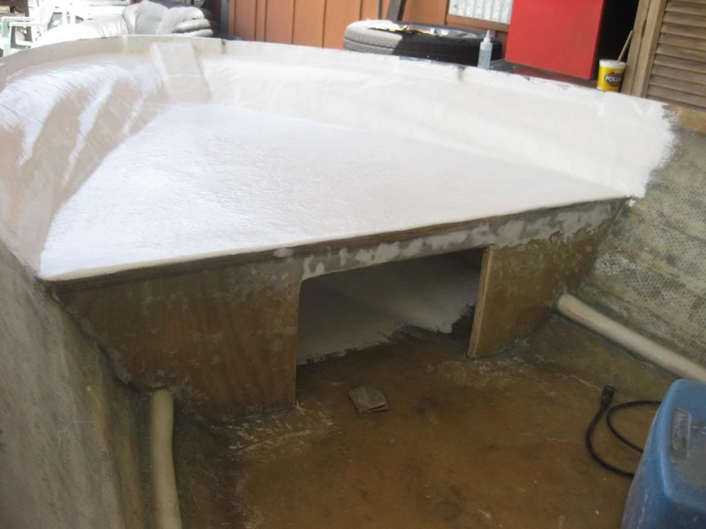

Pic 4 .... Like the pvc raceways and how cool ... Ya don't even have to get out of the boat to get a frosty one out of the fridge ! :cool:

I would only laugh harder if I weren't coughing & snotting so much!! You don't miss anything, Sam. Yeah, family of 5 & 3 refrigerators still can't hold enough food! As far as pic #1, I forgot....I decided to connect the pieces OUTSIDE of that cramped area...then install. It went pretty well. Sealed it up pretty well with resin & couple layers of mat. Only about 15" to get my big head & linebacker shoulders in to do final glassing in. Sure wasn't fun, but it's over now! Gus, I have one option to find that float, & I think it's a good one, but I will sure keep your offer in mind. As always, thanks boys!
