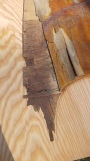

Your staining the marine plywood ? Any reason you didn’t go back with mahogany ?

honestly man go with mahogany you wont regret it where as that grain will never look as good

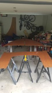

Yeah I completely agree it would look hundreds better if I put the original mahogany back on. It was somewhere around $600 for the sheets of mahogany plus shipping. No one local had it, so I went with the next best thing. But in all honesty I think it'll look good.

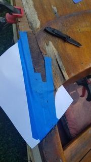

Yep ,cardboard, duct tape, hot glue ... Whatever it take to make a template !

Got first coat of stain on! Exciting.
Just need it to quit raining enough to keep cover off boat and get inside of hull clean!

Looks amazing 'woodonglass'. I may just do that eventually.. As of now I'll stick with what I have. I virtually couldn't get mahogany plywood in my area @ 1/4", so I went with regular marine. I do now see the difference if the grain and how its going to look, but it is what it is.
