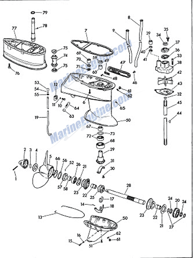

Being a vintage motor, did you replace the clutch dog? I think it's part #`18:
Correct? It's actuated by #19, the shift rod....Right?
But if you've adjusted the cables, to their max, any chance they've stretched & need to be replaced?

Research is worth so much. I think I found the answer to my question.
I hope this fixes the problem.

Re: 1959 evinrude 50hp motor trouble.
Clutch Dog is #25. Shift cradle (#17), is also candidate for wear as are thrust washers (#21)
Yeah, what he said ^^^ :facepalm:
I happened to have that pix saved & didn't cross reference the part #'s. Sorry for the confusion...
