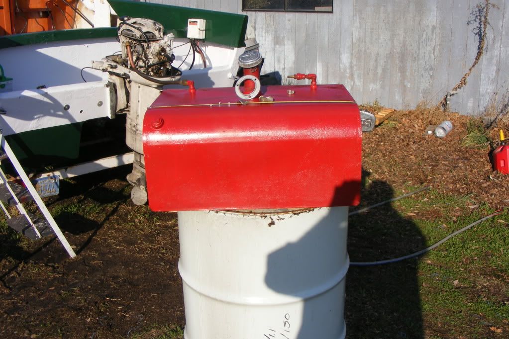

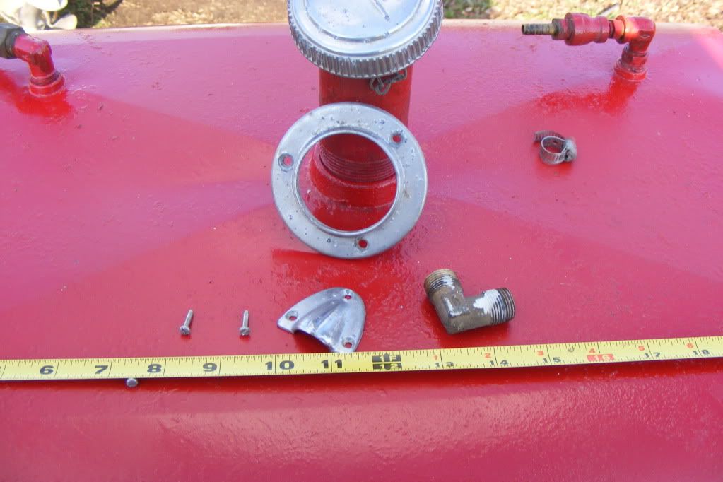

GT1M, I took the fuel tank apart yesterday and cleaned all the fittings. Your Pick up tube was actually there. I was expecting a rubber hose and I had never seen one in there. When I pulled the fittings off the tank I found the tube brass/copper tube inside.
After I took the fittings off, I painted a fresh coat of red on the tank. I will get photos tomorrow.

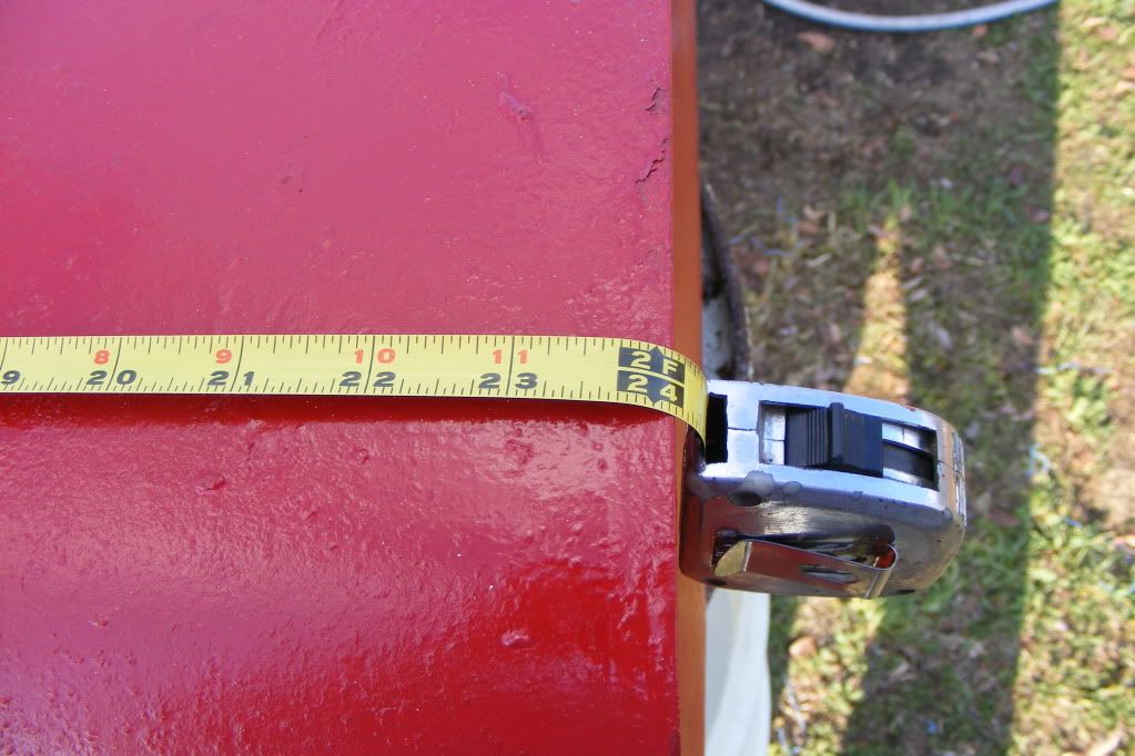

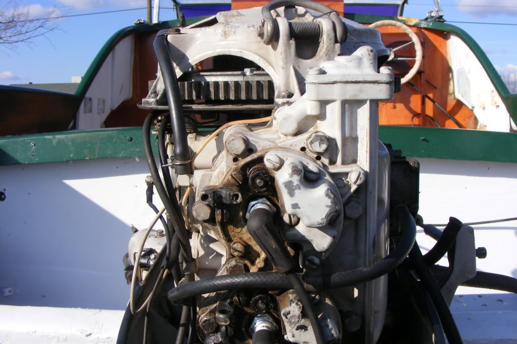

Great news! Glad it was something simple and you were able to get that beauty running. You haven't seen smoke until you run some 24:1 mix through it. Seriously, the full synthetic TCW-3 oil seems to reduce the amount of smoke even more. Thanks for measuring the fuel tank while you were focusing on the motor. I saw the 24inches long dimension but missed the H and W. Post them so we can estimate the tank capacity. That fuel line connector leak is puzzling since I understood you put new parts on both the hose and engine sides. It is possible that the old male fitting damaged the o-ring in the new hose fitting and that's why it leaks after you replaced the male fitting. BTDT.. There are gazillions of the OMC-style fittings in use that don't leak and both Yamaha and Mercury use a similar design. I never really liked them and changed mine to the old Chrysler style. I will post a picture later so you can see what I am talking about. FYI, the cylinder head is definitely a pre-1962 version with the compression release valves. However, the rest of the linkage is missing. Some PO did what he had to do to keep it running. Keep checking things off the list. I can hear the water calling you!
