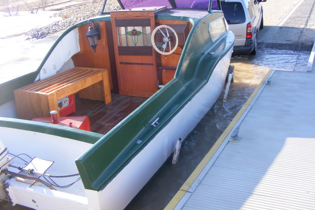

Re: 1959 Glasscat Catamaran Project Underway.
Hey Judge.
Well it has to be tall or I can?t see over the silly cabin. I am going to put seat belts. The people in the seats looking backward will almost be out of the boat!!!!!:facepalm:
yeah your set up is actually intended to stand at the helm...or have a leaning post...so if you want to sit down you would have to have some tall seats indeed....seat belts in a boat can be a bad idea...if you were to flip, it would be better to be thrown out into the water than drug unconscious to the bottom with your boat! that's just my 2 cents of course
+1. NO SEAT BELTS! There's a reason boats don't have them to begin with. As JDA says, if your vessel should turn over and your passengers are strapped in place, things will get real bad real quick. A catamaran is not a kayak, so you won't be Eskimo flipping her over should she capsize. Believe it or not, it's better to be tossed clear of the boat, rather than have it rollover on someone, and always wear a PFD while underway. Per another post, boats aren't cars. No mirrors, no seat belts, no air filters, no hand breaks. A boat is a boat and a car is a car.
Glad you're making progress. It's always fun when you get to the interior and get to do the fun stuff like play around with the layout and accessories. Speaking of which, rather than a seat belt, have you thought about an ejector seat for any unruly passengers, or those that don't want to pitch in for gas? Just a thought :)

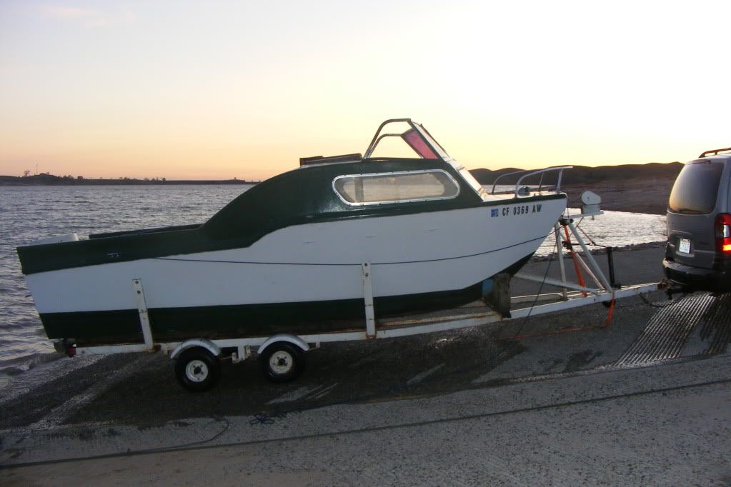

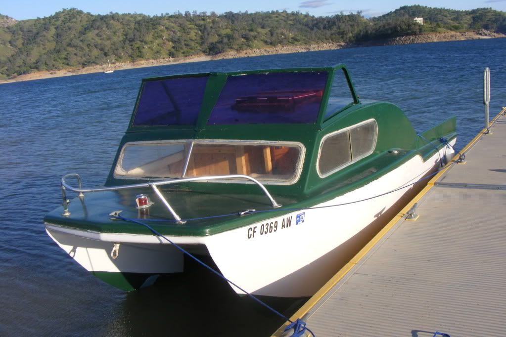

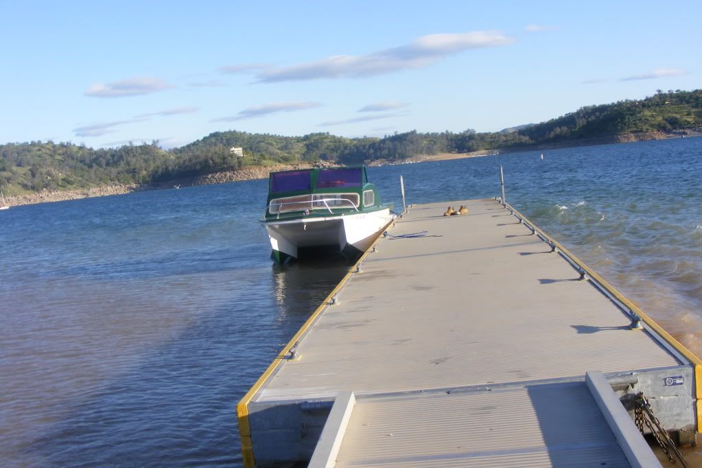

Hey Guys,

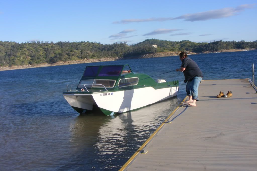

Took the boat to the lake today for a ?sea trial?; boat floated great.:D Motor would not start! Spent 3 hours at the dock. Un freaking believable. :mad:Motor turned over but would not start! (it started a few days ago remember). Then I accidently slipped it into gear I grabbed the wrong control, and now it will not come out of forward gear???? No matter how I wrench on the lever it is completely stuck. I had a miserable day just getting to the lake. Got out to the ?boat yard? around 11 am; found out I had 3 flats. One flat I saw was not a road tire (it came off of a lawn tractor). Took that tire off using a set of long screwdrivers, I put the spare tire on the rim and then after fighting with it got the tire on the rim. It would not set the bead with my little air compressor. SOOOO back into town I drove to get a tire shop to set the bead. I took it to 3 places and nobody could get the bead to set. At the last place (Walmart of all places?.I needed to buy the plugs for the bilges there anyways. The tire tech told me to put a ratchet strap around the tread and cinch the tire onto the rim. Then he told me to fill a trash can full of water (I used my 55 gal drum) and fill it with the strap on it, while underwater; the bubbles will help set the bead. It worked great. There was a little water in the tire after I took the strap off and the tire was filled with air. I took the little fitting out of the valve stem (I forgot what it is called) and the pressure of the air in the tire blew the water out the valve stem. I filled it again and blew the remainder out.
Then I had to rewire the trailer lights when I was mounting the new license plate I noticed the mice had chewed all the wiring loose under the trailer (I had no lights at all) so I had to climb under and rewire the lights. By the time I got a few gals of liquid gold and was heading to the lake it was already 4:00 pm. The park rangers asked why we were coming so late to the lake when we checked in, and went through the long story of the tire and the lights and etc., along with when we told them that we were probably not even going out in the water we just want to see if it floats and how the motor runs. They told us since we were not going out on the lake (and it was very late) they did not charge us a fee for the boat. It only cost 3.50 (half price for the day, normally 7 bux) to cover the day use only. We launched the boat thankfully the lake was empty so I could stay on the dock without bothering a soul. As I said before, we (my mom and I) sat there for 3 hours dorking with the darned thing. When the gear shift stopped working I packed up my toys and went home knowing that it will never start in gear.
It was a beautiful afternoon and although the wind was blowing very hard and raising a large chop on the water (can?t really tell from photos but it was really bad). My mom and I had a nice afternoon together alone (the first time in a looooong time).:D
I am very frustrated with this thing so I am going to take a little while off of it to get my mind right! I probably will not work on it at all for a week or two. I am very annoyed right now. Really what happened to the shift lever?
Lastly before I take it out again I need to put 2X4?s or something for rails. I scratched the boat a little putting it back on the trailer. (nothing bad, just a little paint gouged off). The boat sat really high in the water I can see where I need to do a little more painting on the bow of the pontoons. (I could not get while on the trailer while painting, I thought it would be underwater anyways).
Lastly (again) :facepalm:please excuse my slovenly appearance, I was wearing my mechanics clothes not my boating clothes. Since I was not planning on going and having ?fun?
c-ya guys

One final comment; the wooden bench I built is a little heavy (it is mainly 2X4’s). With my mom, and I sitting on it, on the one side of the boat (and as you see I am not a small boy) the boat did not list or even lean a little.

One more thing…sorry I got too much to talk about tonight. The thing sits so high in the water I was able to launch and trailer it with the motor down. I did not need to tilt at all. Is the boat supposed to sit so HIGH in the water. I mean barely 6-8 inches or so of boat is underwater.

Took the boat to the lake today for a “sea trial”; boat floated great.:D CHECK
My mom and I had a nice afternoon together alone (the first time in a looooong time).:D CHECK
Lastly before I take it out again I need to put 2X4’s or something for rails. CHECK, put some carpet on the 2X4's also.
Dave
Dave, I remember the great feeling of seeing my first boat floating in the lake like it belonged there. Sorry to hear the motor challenged you again but, unfortunately, that is what these 50-60 year old beauties do to earn our respect. I know you can whip it!
Regarding fuel/oil mix, you are correct it should not be much oil per gallon. At 50:1 ratio, it is only 2.672 oz./gal. Next, I would not be too concerned about the boat floating higher in the water than you expected because that is a good thing. Wait and see what it does with full fuel tanks and three or four people. Remember, that boat is designed for a larger motor or twins like yours. Finally, it may not amount to a hill of beans but I recommend you remove what looks like wooden spacer blocks under the trailer winch. They appear to making the cable pull the boat at an angle instead of parallel to the keel which is ideal. Take a break and recharge "your" battery! Bill

GT1000000
Jul 13, 2011
4,916
Wow, no wait...WOW!!!
"Dreams" looks great sitting in its natural environment...that is one super-cool looking boat...
You have done a fantastic job getting it all spruced up...
Don't worry that your sea-trial did'nt go as planned...
When I first got my tub, I lost count, but I think I put it in the water 4 or 5 times, before I actually got most of the bugs sorted out and actually had some fun in it...
Wouldn't start, didn't Pee, wouldn't shift into gear, wouldn't idle, wouldn't rev up in gear, leaked like sieve...etc., etc.
It is part of the price we pay for reviving these old floaters, but in the end it is worth every penny, drop of blood and sweat, and every sleepless night...
You'll get it just right before you know it, and you and your family and friends will be enjoying the water for many years to come...
Take that hiatus for a few, re-enrgize yourself, and then just take it one step at a time...
Keep on having FUN!
Gus
