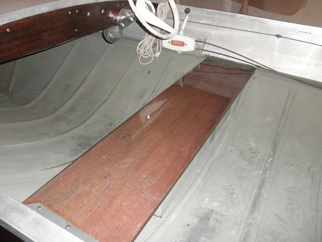

Here is a picture of the floor I made. The wooden slats a strudy and alow water to drain past them. Cheap to make using treated wood that is stained and then sealed with varnish.

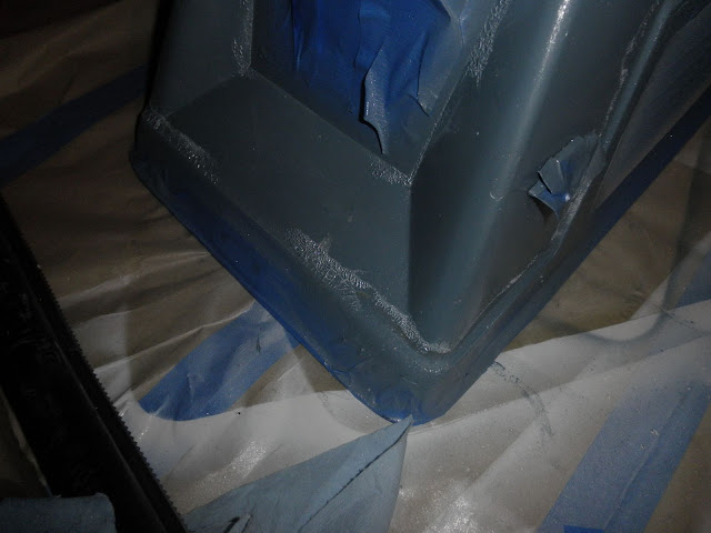

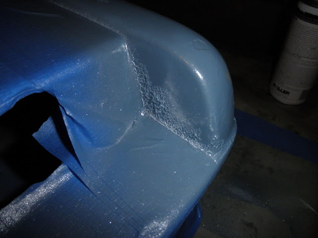

The week has been a nighmare for painting. I'm not sure what changed, but I could not lay down a top coat of paint on anything!
Look at this... After the paint sits for 10-15 minutes, it wrinkles up :mad:
On this motor cover, it was particularly bad. I sanded it all off and started over, wrinkled. Sanded and tried again with a new can of primer followed by a new can of top coat and eveything was fine. Same thin happened on the bow. I've stripped it down 3 times this week, and painted 4. the last coat I put on tonight went down nice...
I have no idea what it is. Looked like solvent or paint stripper had been applied but none have been used. I can't figure out what caused it, or why it stopped happening. I've used the same process I used on the entire project; Scape, Sand, wipe down with dry cotton cloth, 2 prime coats, 3 top coats, each about 2 hrs apart. The only think I can think of is that I got some old or bad paint. Hopefully when I look at in the AM its all the paint is still laying flat. I've got about 2x more time in painting the bow as I do the entire hull.

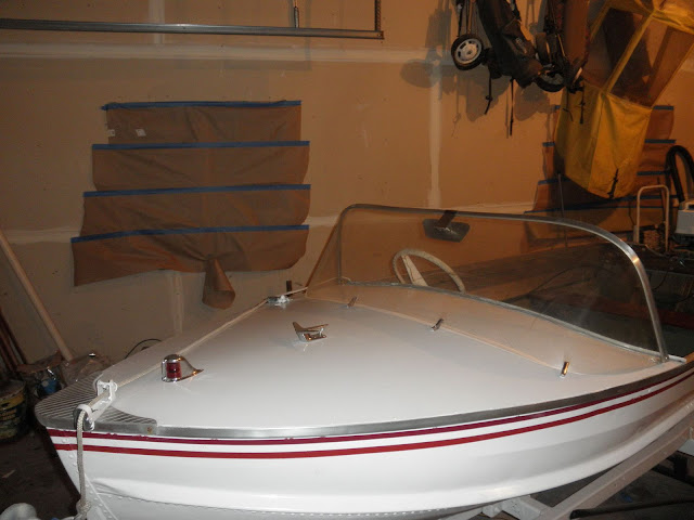

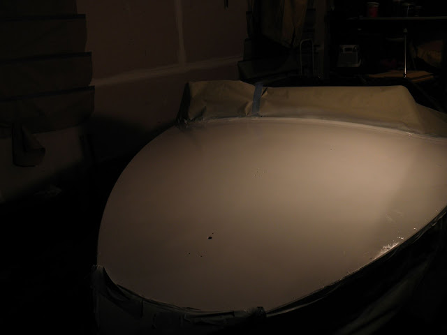

I finally got the bow down without the paint "crinkling up"
I still don't know what I did different, but "3rd time's a charm" as they say
Here's a shot of the bow with all her jewelry back on.
And a shot of the seats after the 3rd coat of UV varnish. The dash turned out good as well.

Did you use a kerosene heater in the garage? I've been told that what you experienced could be from kerosene residue getting on the painting surface.

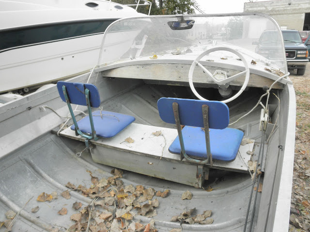

Here is a pic of the seats that came in the boat.
I'm not sure if they were new with the boat. They remind me of "stadium seats".
The garage has a natural gas forced air furnace. The only thin I can think of is that some of the shop rags I have got contanimated.

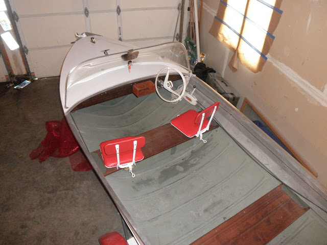

Finally back at the boat project. Been working a lot and no garage time. Anyway, I took the seats apart and recovered them in red vinyl. Sanded down the steel frames, primed and top coated coated. I will get them back together in the AM since their no work on 12/24! I'll post pictures when they are installed.
mdgpl
Oct 3, 2010
52
Re: 1960 14' Seaking
That was a quick. The seat frames were dry this AM. I got the new vinyl sewed and attached to the boards before going to bed last night. I got some new hardware this am to attach with, stainless vs the old std steal rusty stuff.
Here's a picture of the seats mounted in the boat.
Well, thats' about it till spring for this project when we can splash her in. Thanks to all for the comments along the way.
