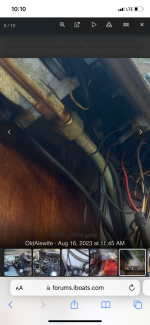

Here’s some more pictures of the important/ugly stuff.
Wiring looked like a mess at first glance, but it’s fairly easy to trace each one. Steering seems to be hydraulic? Moves very smooth and easy. Transom looks very solid, not even any dry rot towards the bottom. The skeg “repair” attempt has zero penetration, so no surprise it busted off again. I see SEI makes replacement lowers which is nice. Outdrives and Tilt systems are completely foreign to me. Thank god for the university of YouTube.

not hydraulic steering. its cable steering. welcome aboard the chieftain adventures. lol.
Is this just a sheath for the cables that keeps lube in? Some liquid residue around the gearbox and thick line.

yes thats cable steering. liquid or thick residue is usually oil or grease used in the cable to keep it lubricated....and working as it should. if it was hydraulic you would have a helm that had 2 barbs on the back of it being hydraulic pump. and 2 hoses running to back of stern to the engine with a piston there for steering. picture for hydraulic reference
