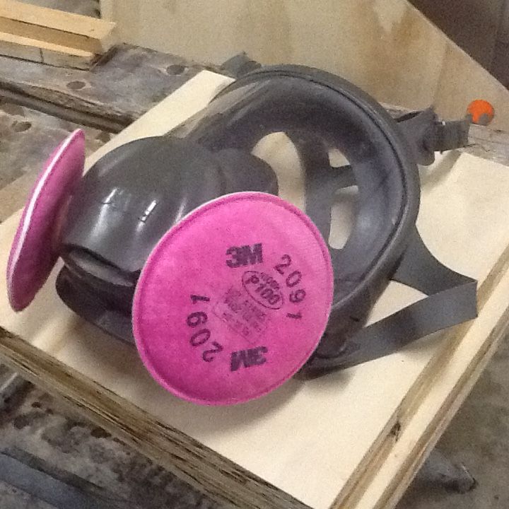

Not sure about the dust mask...there are alot out there that may be better or not but in the tornado your making just keep more replacable filters. On another note when the bottom of my boat got so bad and I got so tired of vacuam and wipe. I put a bucket under the drain hole and powerwashed the crap out with soapy water. The solids fall to the bottom of the bucket. Then I mopped everything with bleach and then mopped again with acetone.
Grinder wheels come in alot of different numbers. 220, 180, 80 grit. Pick the one that kills the glass the fastest. Yea they are red lol. BTW some come for making angles too so you can get into tough spots, if you can't get them then get the next largest size and the excess size allows you to bend into round or angled spots.
IE 4.0 grinder whell recommended but a 4.5 fits your grinder and the flex lets you go into other tought spots.

Today I used a ZEC 16 grit pad on a 7" grinder. That thing is pretty awesome, it came in from Amazon last night, I was pretty excited to use it. It took a lot of material off. Saved a lot more time than a 4" grinder with a 36 grit flap disk or resin disk. I was also using a metal cutting blade today to cut the bedding glass out. It exploded and a chunk slammed my pointer on the right hand. Note to self, "don't do that again, just use the diamond cutting disk." I also found a grinding cup in my tools for the 7" grinder. I think they use it on concrete. Its solid metal with chunks of metal and diamond I believe on the grinding face. Anyone tried these on fiberglass? Looks like it would tear up some glass. Might try it on the bedding putty since its so thick.

Here's some tips. Filters are Cheap..Lungs are NOT!!! Buy More..Replace More Often!!!! STOP and clean the boat NOW! Get all the dust out so your starting with a clean slate then get a box fan an tape a AC filter to the back of it and st it in the boat away from the area you're grinding so it will pull the dust away form you. The filter will clog but you can knock it off to clean it fairly quickly. Two fans work better than one. If the bunks are long then your support should be okay. IF the hull seems spongy then you should add more support under it. If the "Keel" is actually a stringer and NOT just a wood filler piece then I'd make it from plywood. Some keels are just about 2" thick and the cavity is filled with wood and glassed over even with the hull. If yours acts as a stringer and extends up to support the deck then plywood is the way to go.

Hey Kinaiahi,
I used the red (pink 3m 2091) round filters when grinding in a tent. They were a lot less likely to clog up as they have more surface area. The only thing is make sure you're not creating any organic vapors while grinding so I wouldn't use em if there is any sealant or mold growing inside the hull. They are Niosh P100 so safe for hazardous dust. BTW the N95 filter 95% of particles at .3 microns or larger, the P100's filter 99.9%. Here is the one I'm talking about.

Hey Kinaiahi,
Thats the ones that I was talking about, with the exact same reasoning of surface area. Gonna buy some of those! Home Depot here I come:)

Oh, forgot to mention, if you haven't tried them yet they make mylar stick on shields for the face mask. Really saves the screen when the resin starts flinging.

Thanks WOG and RM. Went to HD and they're all out of box fans. Gonna head to walmart and see if they have anything in tomorrow. Had a mylar shield and took it off because all the dust got in between on some spots and got cloudy. Came with the mask, not sure where I would get more? Amazon maybe??? HD did have the pink P100 filters though.
