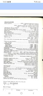

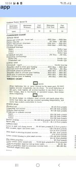

For anyone else that finds this thread in the future for a similar problem hears all the tec specs iv found

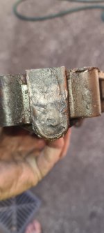

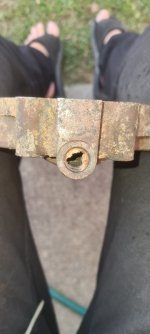

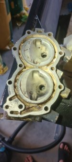

Core plug has completely **** its self glad I bit the bullet and ordered 1 the same time as the gasket just need to wait till Tuesday when they arrive now

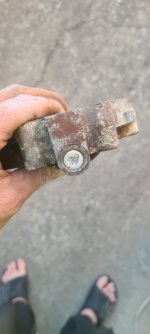

Thought I'd check the thermostat well im at it and there isn't 1 in there is it common for ppl to remove them cose it works better with out 1 on these motors?
Or should I definitely get 1

I checked the other head and it had a thermostat in it was pretty grubby so I threw it in to soak with the carbie im currently cleaning up if it's still stuffed I'll order a new one there cheap enough was just curious why there was no thermostat in there
Probably should of checked that when I changed the heads over

One of mine didn’t have one. Forgot why people remove them. Just order a new one with new gasket and don’t look back. Or test the one you found after you clean it up. Put it in hot water and see if it opens etc

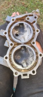

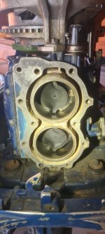

Got a question about the core plugs are the designed to be a weak point incase there's a pressure build up issue such as a blockage somewhere water can't get out so the core plug gives way instead?
I only ask as I was looking at my spare head with the striped sparkplug hole and someone went to alot of effort to seal it right up I'll post a pic
Is this a good idea or a bad idea?

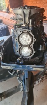

Well that's about as good as the old girls gonna get
I did tap the core plug a lil to hard but lesson learned gentle taps next time

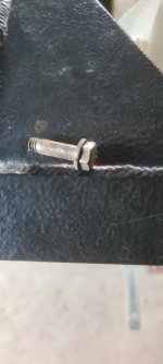

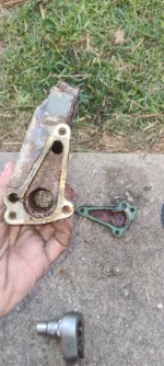

Well smacked the hell outta my knuckles and that hurt alot less than the knowledge of what just happened
I was only upto 80inch pounds of torque when it snaped so not even done upto requirements yet
