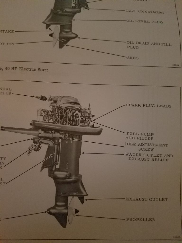

It's throttled down all the way, I adjusted the one labeled idle adjustment screw in the diagram in the book. I'm assuming that's the same as the throttle stop you mentioned? It's all the way out.
I thought it sounded pretty good besides the high idle, since I got it pumping water it starts up with one turn of the starter.

I think you might check the tower up above the idle adjustment screw (what I call the throttle stop). Reach in with your fingers to the stop where the screw makes contact (when screwed in) at the bottom. See if you can turn the tower and linkage counter clockwise a bit by pulling on that stop. The timing/ignition plate up under the flywheel make be stuck due to old grease underneath. (can also try to reach under and turn the plate c.clockwise a little by hand.) I'm guessing, of course.
good that you distinguish between the throttle idle screw and the carb mix screw. If the motor idles well as it seems to (if a little high), and goes into gear smoothly (no stalling), the mix seems to be adjusted correctly.

After a long, busy, and enjoyable day I was only able to mess with it for about 15 mins before it was dark out. I could see next to the idle adjustment that there's like little notches for different throttle positions and it was on the third notch, not the first. I adjusted the linkage while motor was running and idle went down but still seemed high and wouldn't stay running. I see some grease build up by those notches so I'm going to clean that up a little tomorrow and also see what I can do with your other suggestions.
