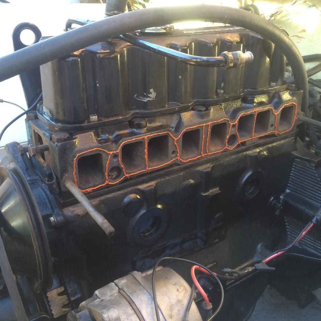

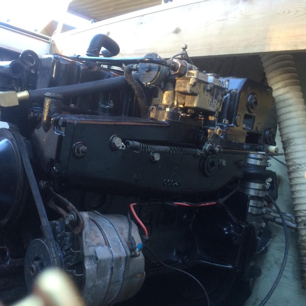

Started going thru engine, Points plugs condenser, Last registered in "08 The whole fuel system was a complete mess. 3 hours to clean the carb. All new exhaust/cooling gaskets. Thermostat, Oil system, Rigging, Cold night out went for the water Impeller. Trim system work. Other than than that was ready to run run. got it to start about 2am. set timing and it ran perfect.
Motor work, points,plugs,condensor,3 hrs carb cleaning,watersystem,exhaust,riser,timing,rigging, drains,oil system,alernator,fuel system,trim system etc. - See more at: http://s1077.photobucket.com/user/se....FU1c26Di.dpuf

Burning the midnight oil I see, it's fantastic that you're fortunate enough to have found a Chief in such good condition.
Keep an eye on that hose fitting on the front of the manifold, from the pic it looks like it could need replaced due to the pitting you may have to double clamp that sucker or get a wide band clamp to keep it from leaking on you.

We spent allot of time descaling the inside of water system, And if you notice the neck is black, that's that rust converter you brush on it neutralizes rust, will let you know in a year or two if I BELIEVE IN IT OR NOT. The trailer is rust colored but its more like the rust colored stain bleed thru the white paint so its more stained than flaky rust, When I get the boat off in spring we will paint the trailer,new lights,rollers,found new springs in the boat, repair guides, and get matching sized wheels would be nice. and all new bearings and races. new winch, other than that its a really strong trailer.

OK, just trying to catch up. After we got the motor online needed to test, Found a 55 degree day in January, and went for test run. No chairs, tools only. After resetting timing to 6' and was able to achieve 4000 RPM and 35 MPH. One of my first questions, testing in driveway shifting felt really good, but out on water seemed to bind up little more going thru transition F-N-R and back, needed it to idle way down for clean shift. Have you guys experienced this and best way to rig out? Seems like a balance between idle speed vs.slightly higher timing.

Looks real good on the water, Check the stickys in the Mercruiser section for Achris's video on adjusting the lower shift cable. It is very critical to good shifting. If you shift it for a while out of adjustment with too much force you will stretch the lower cable and have to replace it.
