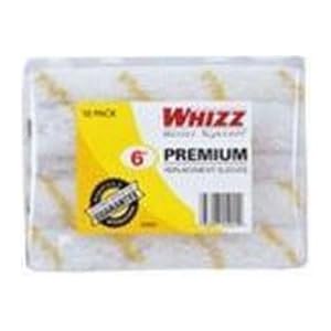

i ordered 2 different types of rollers...what ever the guy at uscomposites said i needed....one style for resin and one for rolling out the glass
Woodonglass
Dec 29, 2009
25,930
Re: 1973 SRV 220 OV Resto
Yep the one for rolling out the glass is what I call a Bubble Roller. I use the 6" rollers from HD for rolling the resin after I scrape em down with a hack saw blade to De-Fuzz em.;)
