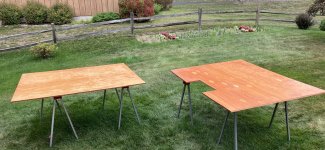

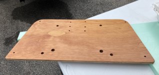

So far this afternoon I put the first coat of West Systems epoxy onto the bottom surface and outside edges of the aft flooring plywood, and also onto the back surface of the motor transom plywood piece. Tomorrow I will put a second epoxy coat on these two pieces of plywood if all goes well. Painted the epoxy coat on with a wide disposable foam brush and then used a squeegee to remove the excess epoxy from the painted surface. Now I will get the next flooring sheet ready…

The Admiral and I put the first West Systems epoxy coat on the bottom of the second piece of plywood flooring. Moving right along…for us. 😁

Second coat of West Systems epoxy is now on the bottom surface of the above plywood pieces, and, I coated the inside surface on all of the transom piece holes. Had run out of the epoxy last evening so the Admiral and I took a color drive into town today and bought another epoxy round. Should have enough to finish the remaining flooring pieces now.
