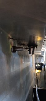

Land based water test of head complete!
The Jabsco marine toilet seems awesome in testing so far. Flushes water nice and consistently all the way around the rim which is really nice, if you pump it down fast it even produces a whirlpool like a land toilet! Now I will have an easy way to tell what hemisphere I am boating in without any connection to reality or the outside world. Life goal #79 attained.
Used onboard water tank and yet to be mounted faucet to keep filling a 5g bucket to use as flush water since the thru hull is high and dry. It takes over 100 flushes with full pump cycles (1 pull all the way up and push back down) to use up 5 gallons of water. Seems super efficient! I added running water to the bowl while flushing a bunch of times to eventually fill the 15g holding tank bc flushes alone would wear out the pump lol Once tank was full I hot wired the macerator quick and it drained the tank in only about 2 minutes both times. Rim of toilet is well above waterline so hoping I can keep plumbing as short and simple as I have it now with no anti-siphon loops.IMG_20230907_155654.jpgIMG_20230907_172716.jpgIMG_20230907_172720.jpgIMG_20230907_180854.jpgIMG_20230907_172650.jpgIMG_20230907_180923.jpgIMG_20230907_172728.jpgIMG_20230907_195844.jpgIMG_20230907_195940.jpgIMG_20230907_195906.jpgIMG_20230907_195957.jpgIMG_20230907_201045.jpgIMG_20230907_180939.jpg
