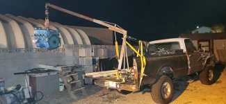

So lost compression on motor. Been waiting to post picks so you all could call me crazy.... this is coming out

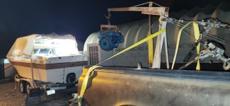

And this is going back in.
Boom w/extension has 3 different layers of square tubing. The outer is .250 wall. Hope to run it this weekend on the hose and be out next weekend. This summer sucked for boating between new motor for truck and now this....
