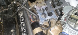

Got it to idle a bit better:
  • Tightned the carb nuts with a 1/4" ratchet instead of a nut driver.
  • Discovered I had a loose connection at the engine wiring harness plug (causing me to lose all 12V power after idling a bit)
Still has a bad vacuum leak. In addition to the PCV issues, I'm pretty sure my carb/carb spacer gaskets are wrong. used the same soft paper/foam type eBay gaskets (4 bore) on both sides of the spacer. Might be wrong.
Will edit in some pics.

A few more notes based on research I'm doing:
  • Per several youtube and eBay references (along with parts lists confirming the use of a breather oil cap with steel wool media), the 888 is in fact a stock PCV setup (never ran vent tubes the flame arrestor). But, I have yet to find a parts list that calls out what the PCV valve was supposed to be. If nothing else, since I'm strictly freshwater, I might just grab the generic automotive 302 PCV and call it a day.
  • The carb spacer is a custom modded part... that vacuum port was drilled and tapped by somebody (and any more, Edelbrock 8711 is currently a plastic part!).
  • I think I might be able to nuke the spacer entirely. The intake (an Edelbrock performer 289) has several threaded vacuum ports that I could put a barbed fitting into and run my hose with such. But I don't think the throttle lever will clear the water hoses on top of the intake. Edit- Nah, the spacer with a port is correct. The similar (stock 4 barrel) Mercruiser 233 (5.7L) had a PCV barb at the carb base... this setup is meant to simulate it. Just need to replace the air chuck with a proper barb, the cobbled line with something proper (high pressure automotive fuel hose ok?), and the PCV with something appropriate.
  • Edit2- Since the carb was factory tuned for the later Mercury 5.0 that didn't use PCV, I'm reading that I may need bigger primary jets. Currently I have .057 jets (factory is supposedly 0.58, but whatever). I also have a 6.5 power valve installed but I have an 8.5 that was an option in the carb kit. Either of these options suggested? Edit3- Nah... supposedly the idle screws are enough, unless the 888's 351 cam is different from the later 5.0 and has more lift/duration? Edit4- Nah, if anything they're the same more or less.
Edit4- Probably a mix of the PCV and moron here not having the idle tuned right. It wasn't idling great but it was idling until the power cut (due to the loose connector). I also noticed that barely moving the throttle resulted in engine racing (tried to go to 3000RPM, I pulled back immediately!)... probably way too lean, if not a vacuum leak?

Took the PCV apart:
  • Looks like the big hose (Marked "Motorcraft 5-55") and it's PCV valve (an aluminum Motorcraft EV8, Made in USA šŸ‡ŗšŸ‡ø) are in fact stock. The hose isn't in that bad of shape for 48 years old... some mild internal cracking on the very ends (past the spring clips) but the working area is crack and rot free. The PCV valve is still moving nice, and moving a lot nicer after rinsing it with some carb cleaner. Call me cheap, but I'll reuse both of these (although I may swap the hose for a molded replacement, some of my old ford truck suppliers make such things). The hose and PCV nipple are 1/2"
  • The other hose is just automotive fuel line. Where it curves it hits the intake... and the cardboard they had as an insulator is there because the hose was actually burnt to a crisp! Didn't have any obvious through-cracks, but not a good part at all. I can do better!
  • The carb spacer is tapped for 1/4NPT... not sure if that's something edelbrock made as a custom part or if somebody else did it (if they did, it looks well machined).
New plan: ($40 shipped on Summit racing)
  1. To fix the carb spacer to intake sealing issue, I found a fel-pro marine gasket that should fit the bill (17847)... Holley 4150/4160 bolt pattern, 1/4" thick, open center (which I read is good- allows some crossover). With some photo editing, here's what that gasket will roughly look like CarbGasketSimulation.jpg
    Should fill the gap nicely. Closer to/better than what was there originally (I think it was 1/8, thicker than what I currently have!
  2. To fix the PCV issue, it's easy. Spin the spacer 180° and install a proper barb (such as this one I ordered). Might need to trim the hose due the 4 barrel being longer than the original 2 barrel, but I think that'll work a lot better than having the extra loop that burns up...

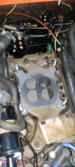

Got some work done yesterday and some headway today.
First, tried to install the new parts. Had to get longer carb studs (and even with the new ones, they're still too short to thread into the intake all the way šŸ˜•). And found out that rather than tapping the PCV port, they shoved the fitting in:
While I was out of town the afternoon, I got said studs and a 1/4 NPT tap. Now, we're talking:
New fuel line:

Finally had the time (and weather) to do some more work.
Hose tested the risers... other than the hose/riser combo acting like a plumbing trap (which makes sense, duh), flowed fine.
Per my wife, the starboard riser is discharging as one would expect (most flow out of starboard gimbal bypass, with some also out of the prop and port bypass), but for whatever reason, the port side hardly discharges out the prop (most came out the port gimbal bypass, with some out the starboard bypass, and a small amount out the prop). This an issue?
Also indirectly checked the manifolds... all of that is flowing nicely as well.
Noticed that the T-stat had been RTVd (with the clear stuff no less 😳)... popped that open, found that a gasket was also used and the T-stat installed is a 160 degree aftermarket unit (automotive???).
So, I've ordered a new impeller (not the kit, since I recently did the full kit and it has hardly run since then) and t-stat kit (new gasket, 140 degree t-stat), both are Sierra (Pretty sure the impeller kit I used last time was also Sierra, I've read that they sometimes are a slightly different size than OEM and mixing can be an issue).
