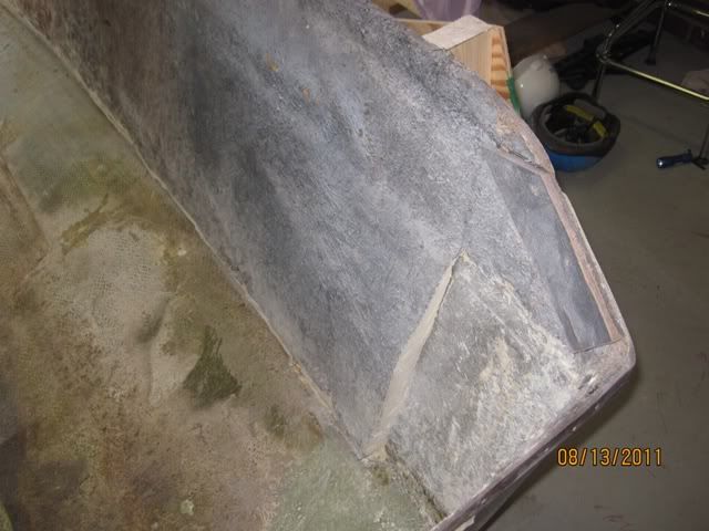

Check out the transome rot. You can see a clear transition between rot and good material - there aint much good left.
Finally got the big glass sheets up. I used a hammer and chisel one layer at a time.
Question: Have you experts ever seen anything like what is shown in the last picture. I looks like the sides of the boat are made of a foam CSM laminate. Any special precautions here?

This foam on the side is messing me up. It is easy to remove, however, it increases the wall stiffness a lot. I am having a really difficult time removing the carpet adhesive out of the original coarse fibered CSM. Suggestions for adhesive removal???

I read a bunch of posts last night about adhesive removal. I decided not to mess with the foam core material - I am glassing back over the top after I have finished prep.
I tried MEK for several hour last night. It did a good job in breaking down the carpet backing, but made a gooey mess out of the adhesive. I can darn near stick new carpet back down in the state that it is in now. There were several post about using paint strpper for adhesive removal.
Will paint stripper mess up my foam or make a surface that is no adequate for proper glass bonding?

That's quite the cradle you constructed! That boat shouldn't move a muscle. As for the foam, I think they put that there for flotation and then glassed it in to hold it in place. I have seen this on a few parts boats I've had.

On the topic of that foam core in the side of the hull in the last picture. On a scale of 1 to 10, how important is this for the structure of the boat? Gobs of adhesive is keyed into the fibers of the sheet of CSM coating the inboard side. If I cannot get the adhesive out (I'm losing hope), I would prefer to just take out this foam. I asked a general adhesive removal question in another thread (does not need to be re-visited here).

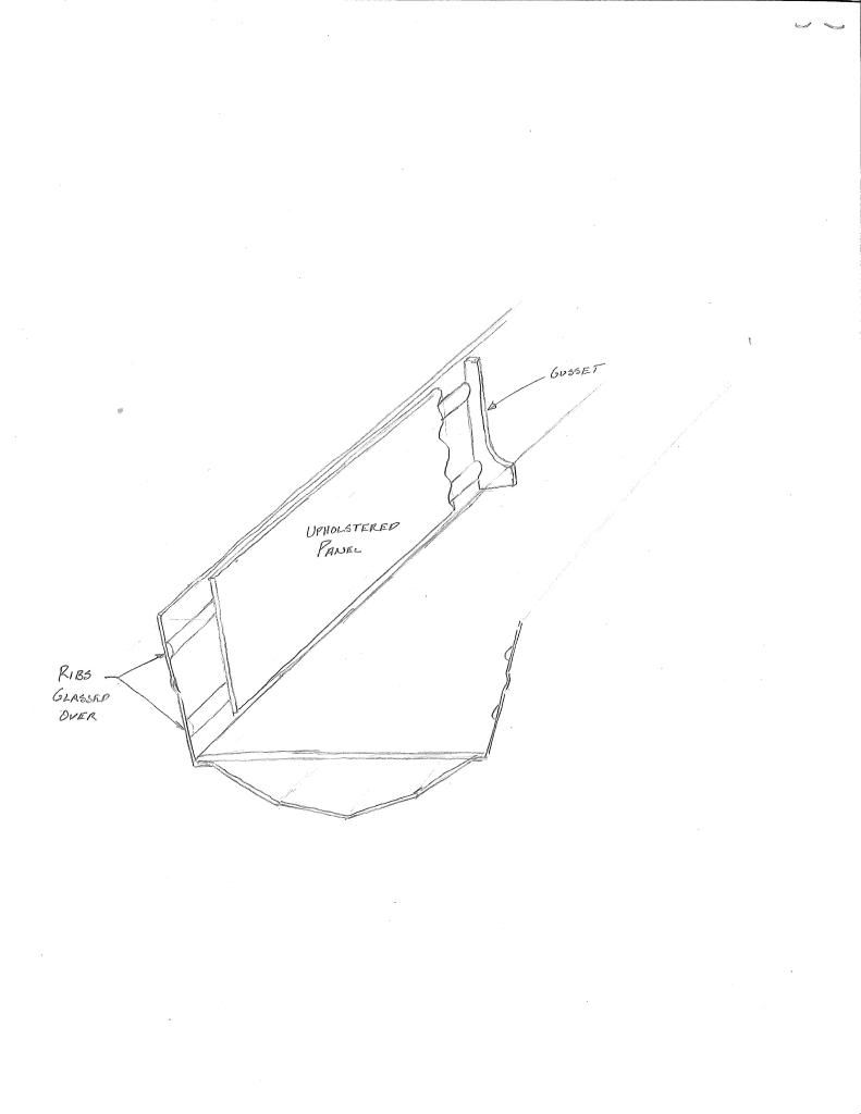

About this stiffness thing with removing the foam core material... What if I ran a couple of ribs down the length of the side of the hull and stiffened them with fiberglass. Then ran a couple of glass gussets in my engine compartment and up near the bow to tie the whole membrane together.
I could upholster a thin glassed pannel and then attach to the longitudinal ribs.

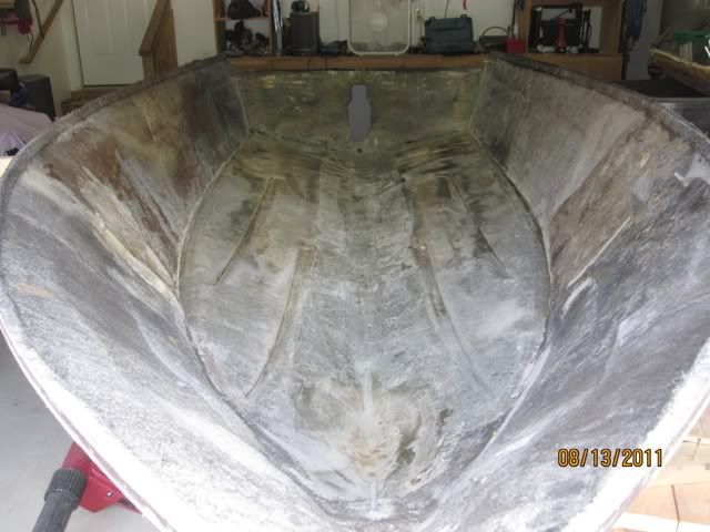

SANDED!!!!!!!!
12 full hours of sanding Saturday! I have a whole new appreciation for this project!
Now I need to start heading the other direction and actually start to build. I am really excited.
