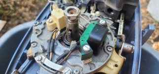

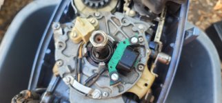

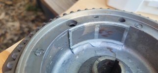

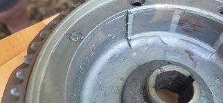

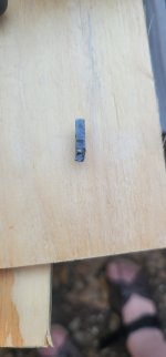

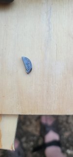

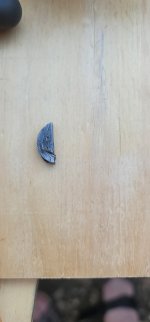

oookay.... so I got the flywheel off... pretty uneventfully... and I think I know what happened.
Inside the flywheel I found the key that inserts into the shaft was loose underneath the flywheel and wedged in between the flywheel itself and the magnet inside.
I also think I figured out how it got loose... the flywheel nut on top is super easy to loosen.
I'm going to upload pics in just a sec... I just need to figure out how to make this nut stay on... I suspect this is the reason it got borked to begin with.

Mc Tool
Lieutenant
Aug 7, 2024
1,292
Maybe somebody has had the flywheel off recently . I have seen where when one is fitting the flywheel the key is picked up by the flywheel magnets , begs the question tho why the flywheel was removed in the 1st place. Stick it back together and see how it goes 🙂
