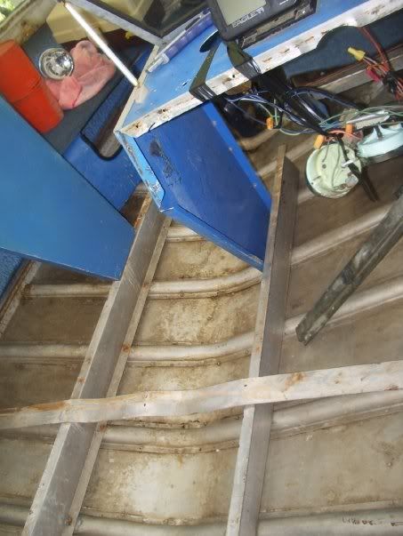

We intended to replace a couple bad dashboards to stop the floppy steering but every time we put a screw anywhere - it just slopped around due to rot. Also intended to make a patch for the one soft spot in the deck. Pulled the carpet back in the worst spot and was floored......the previous owners did replace the decking but with particle board painted with water seal (thompson's or some other similar worthless junk) and stuffed open cell styrofoam into every nook and cranny preventing the hull from draining. I lost it a bit and demanded that we fix that nonsense.
We tore her down over the last few days and replaced every speck of wood but the transom. It's soft but isn't flexing yet so no need at the moment.
A few pics of the tear down and work back up. Also I guess I should mention that I have been completely down due to a herniated L1 disk that the docs want to operate on so I had to talk my family doc into giving me a shot of toradol every day for a bit and I have an endless supply of lortab since they all think I'm dying. I'm not dying - I'm just in a lot of pain.
Decking - lovely huh?
Her hull from the inside - no major issues. Looking good.
