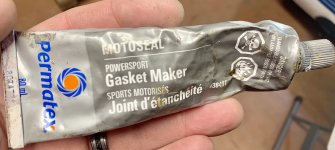

Following up to share success in resealing the bowl.
I cut the seal. I fit it in place and cut off a piece as it was too long. I fit the seal tightly in its grove ensuring a good tight fit. Removed seal. Carefully applied a thin layer of Permatex Motorseal sealant which does not break down when in contact with gasoline. I put a little extra where the cut seal joins. I let it set up, carefully pushing the seal back in place where it tended to move a little. Sealant was given time to set up. All appeared good. Put a thin layer on the outer surface of the seal where the bowl contacts it. Used my finger to spread and smear a thin layer. Let it sit for 20 mins. Installed bowl and tightened it down. Re-installed carb and let it sit for a few hours to let the sealant to cure. Hooked up the fuel line. Primed bowl with the hose bulb. No leaks. Started engine ran for 20 mins at various RPM. No leaks.
How long will it last.? How long until sealant breaks down? Will it? Time will tell. Will test on my boat on the water later today. I will update this thread as time passes. So far this is the first time the bowl has sealed properly despite my efforts. Wish me luck.

I used something similar to seal the gaskets on my fuel tank sender. It seems to hold up. Hopefully you have the same luck.
I am concerned about you not being able to find a carb bowl seal that works. Is it possible that you got some old stock (pre-etoh) when you bought the new gaskets? The swelling of the seals should not happen.

That is an old school compression (seal) gasket. One time use only.
Had the same issue in my old 2 stroke golf cart where the orginal gasket is NLA.
It took some searching, but was able to find the proper “square” , nitrile seal for the groove. Had to buy a box of 100 (life time supply +) but $25 well spent given the alternative.
I would not use gasket maker on a carb unless deemed “disposable”. When the stuff breaks down you end up with a carb full $rap. Clog a jet, run lean and blow up the motor

Agreed @dingbat if/when the silicone breaks down if will plug up carb orifices. I wanted to do something to prove where the leak was coming from. My mind was settled when this worked. I will consider finding a quad ring to seal it up long-term. Something ethanol-proof.
Nitrile or viton….watch the durometer.
90 durometer Viton is too hard for a carb gasket
