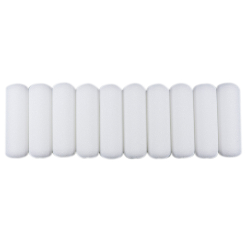

I agree with EZ, the Roll n' Roll technique works really well. What Kind of rollers R U using? The Ultra Fine Foam rollers for cabinet painting work the best IMHO..
I'm using 4" foam similar to the ones you posted. Interlux says to use 3/16 nap roller? Not sure if I'll try that or not? One think I found out after the fact, is when mixing epoxy I was suppose to leave the mix sit in the pot for 1/2 hour. ( It's called induction ) I didn't do that? I mixed very thoroughly like poly resin... Dang it! I hope I don't have any issues?

Roll/Roll probably only works with foam rollers.
I'll try that tonight on coat 3....

How long R U Waiting to do the second roll out. Should be about 5 minutes. The videos I posted are using Interlux paint with foam rollers and he had great results.
Shoot, I was rolling on 2' section, then immediately second roll out. Tonight I'll roll larger sections, wait 5 min, and do second roll out... I may be able to roll entire side of bottom, then by the time I'm at the end, I could start second roll out... Interlux said not to use foam rollers? The tech insisted on 3/16" nap to reduce bubbles and get correct coverage. I'll try your method tonight! I think the Brightside Interlux used in the video is a much different beast then this epoxy system...
