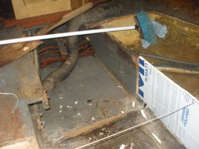

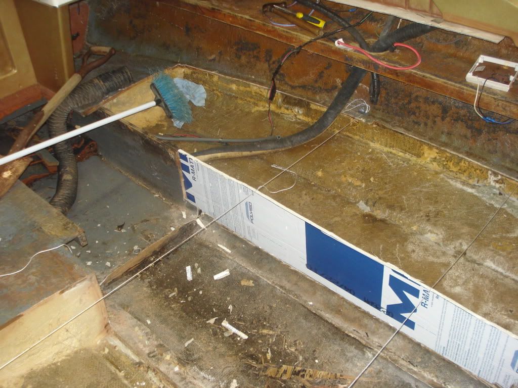

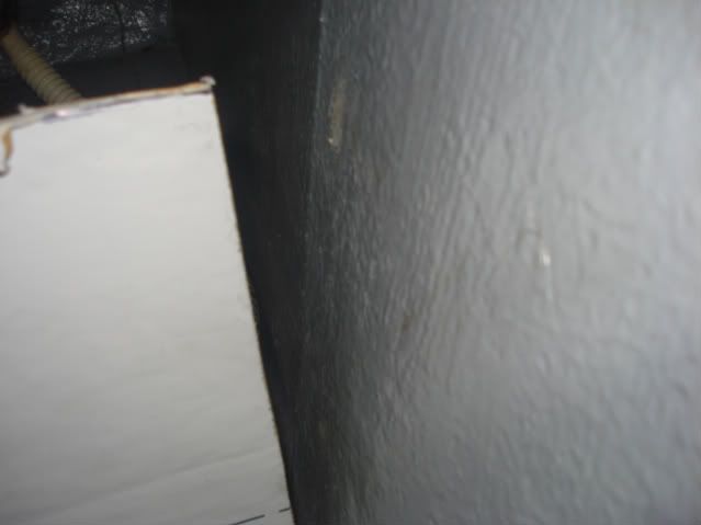

Alright, so last night I got the stringers for the middle of the boat cut out. I am working on measuring the stringers that go along the perimeter of the hull. There is a gap, approximately 2 inches and it goes in a upside pyramid shape where the transom and the stringer meets. Do I have to fill in this area with a small piece of wood, or resin peanut butter, or do I have to do anything with it. When you look at it, the stringers only really touches the transom for about 3 inches. IT is very hard to describe, so I will try to post some pictures tonight when I get home from work.
Thanks,
Yorke
yjanray
Jul 30, 2009
257
Re: 1979 Sea Ray SRV 190 Deck/Foam

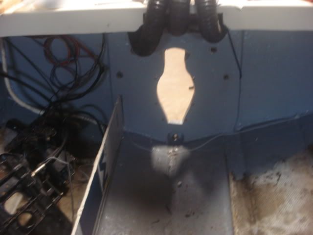

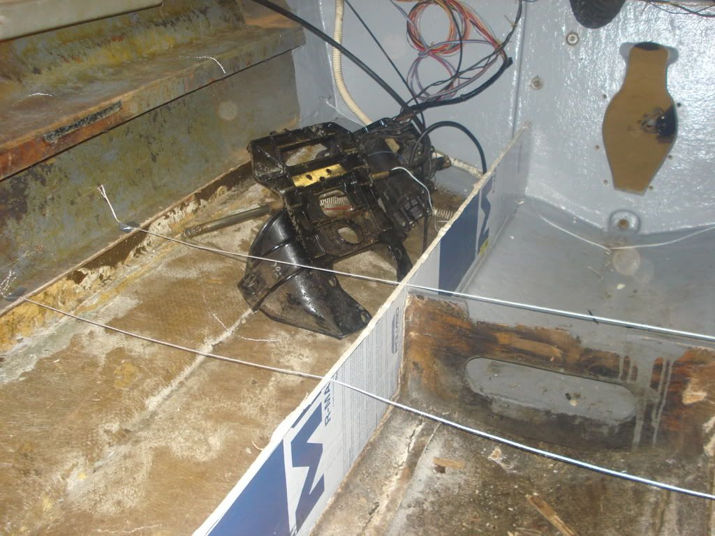

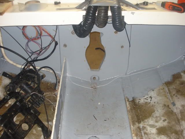

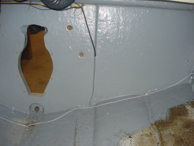

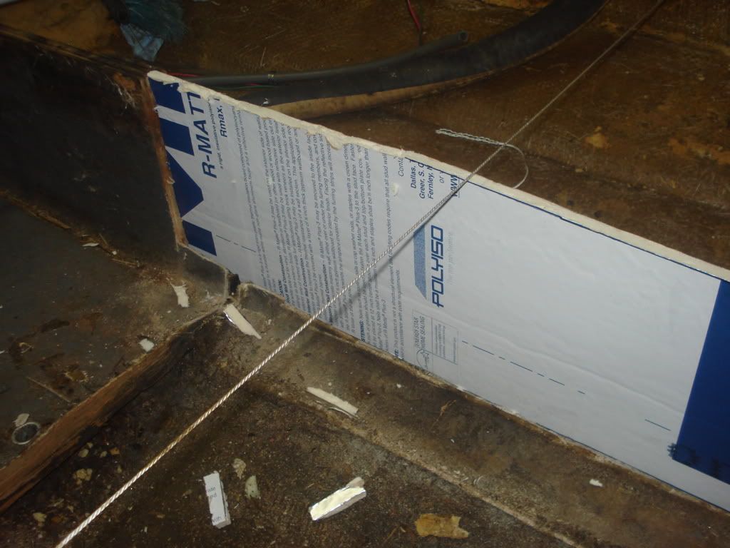

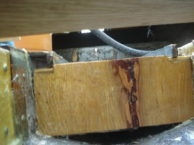

ok, here are some pictures of what I'm talking about. the pictures are just of the blueboard template I used, but was wondering about the gap at the transom? does it need to be filled in with reisn, wood, or something?
Thanks,
Lots more questions, and hopefully answers, to come
Yorke
new transom
gap in question
another picture
one more of the transom

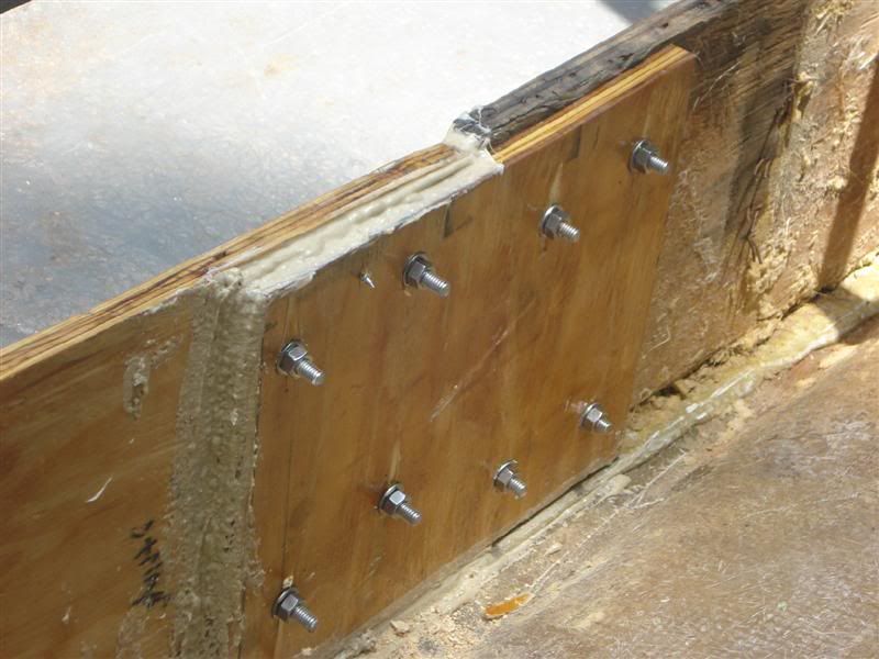

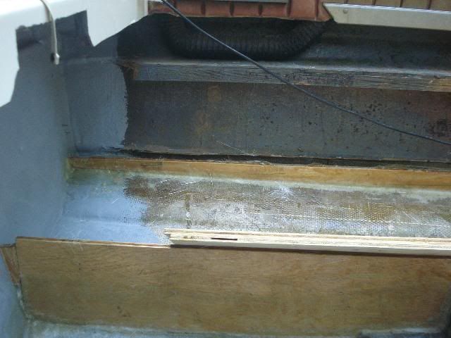

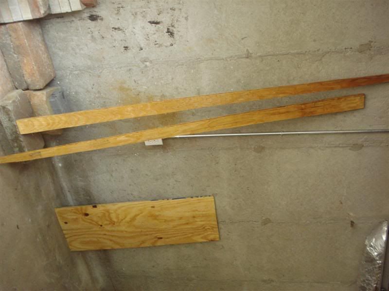

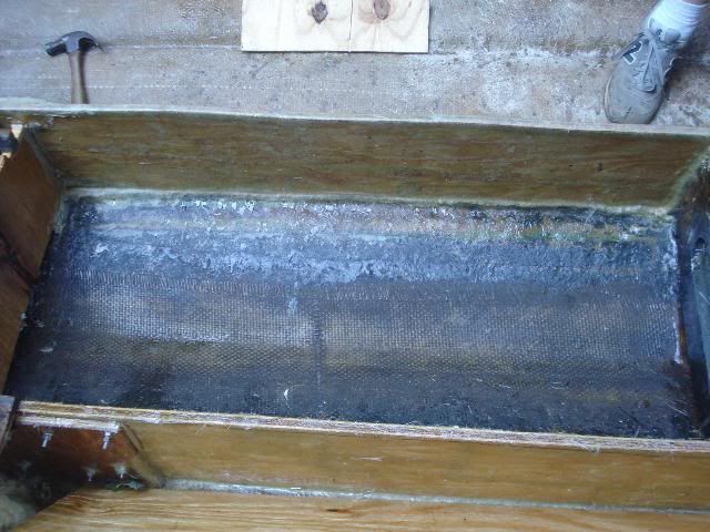

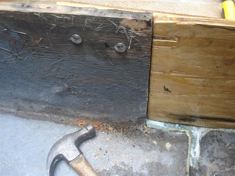

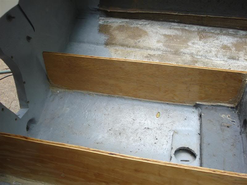

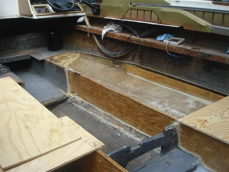

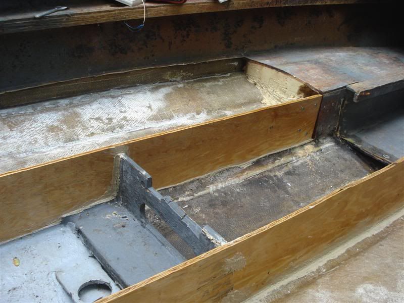

Alright, well i worked the boat for 3 days straight, and didn't nearly get all that I wanted to get accomplished. However, I did get the hull cleaned out, the stringers cut, sealed, and bedded to the hull.
So heres the stringer boards
and here is one of the stingers in the boat
I used a scab piece to attach the new stringer to the existing stringer using 8 5/16" stainless steel carriage bolts
The scab pieces i used to attach the stringers to the old stringers were coated in resin and PL'ed to the existing and new stringer before bolting them in. right now, the stringers are just held in place with those bolts in the front and PL, and they are really strong. I am going to tab them in and cap them off tonight, so they should be super strong.
and heres a shot of the exterior stringers
So I got all the stringers bedded in over the three day weekend I had. YOu think you will have plenty of time, but the prep work and cutting took two full days. Actually putting everything in only took about 6 hours. I hope to get the deck installed this weekend. I'll update with some more pics later on.

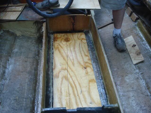

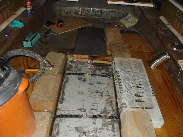

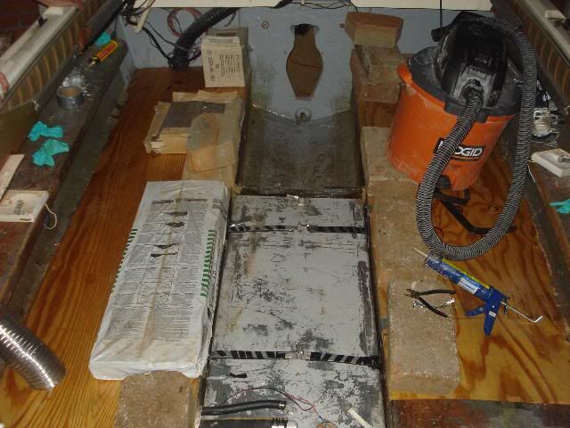

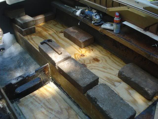

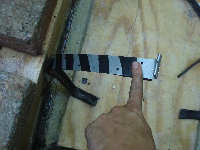

Alright, well its been a while since I last posted. Since the last update, I have got the bulk heads installed, using PL and fiberglass mat. I have got the gas tank installed. I had a small problem with the gas tank. When I was removing everything during the tear down, i seemed to misplace one of the straps holding the gas tank in place, so I had to improvise and make a new one. Anyway, got the stringers capped, which was very difficult. Wound up putting the fiberglass up the side of the stringer, then cutting it, and laying a small piece on top of the stinger as a cap, then put another layer on the top of the stringer and along the sides, to avoid a huge bubble that formed when I just capped the stringers with one large piece of fiberglass.
I have got the deck installed. I glued the deck to the stringers with PL, then uses peanut butter to seal the edges along the hull and along the interior stringers, in the bilge area. Then, i screwed the deck down with SS screws and sealed the holes with PL and PB.
Ah, yes I forgot about the foam. poured 32 pounds of thew 2lb density foam into the cavity. The deck is solid as a rock now. I used the .5 inch ply, which is really about .44 inch or so, and it was a little flimsy when you stepped in the center of the board. After the foam was installed, the deck feels like its a rock. I feel the entire structure, stringers, deck and hull, are alot more ridged now with the foam in place.
Just finished fiberglassing the deck into the hull, and got all but about 2 SF finished, have to go pick up some more poly resin. But pretty much, the structure is done. Going to work on the carpet this weekend, and hopefully get her splashed soon..... So here are some pictures.
Thanks

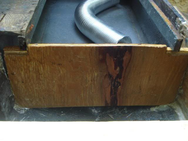

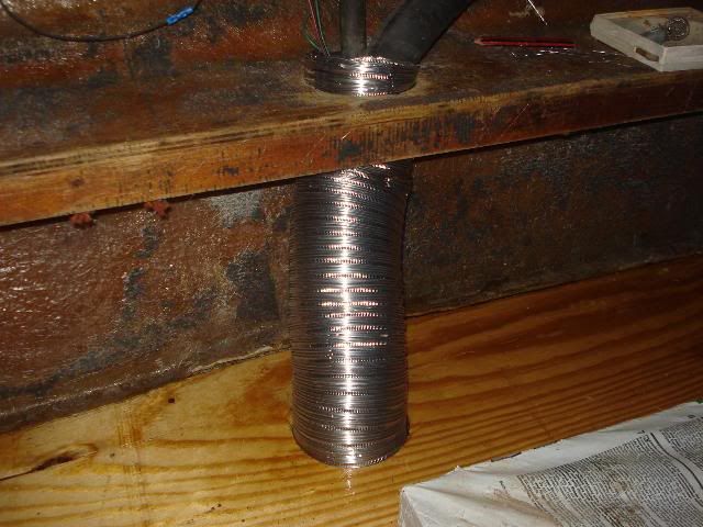

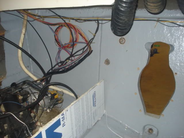

stringers with fiberglass ready to be capped. there is the fuel lines, enclosed in a dryer vent....seemed like it would be a good idea, at least I would be able to pull the lines out from under deck if I needed to change them. Sea Ray just had those things held in there with a ton of 'not wetted out' engouth fiberglass and bilge vent hose I think...
ski locker bulk head in place
fuel tank compartment, before the bottom support was installed
support installed
more pics in another post

shot of fuel lines nice and sealed up, to keep water out of there. I am pretty sure this was the area where water got under deck last time. There was just a huge gaping hole where the fuel lines exited the deck, that lead right to under deck
ahh, the foam
gas tank installed
you can see the foreground of the pic, one of the straps is larger than the other three. thats the one I made.....with some supports for duct work...

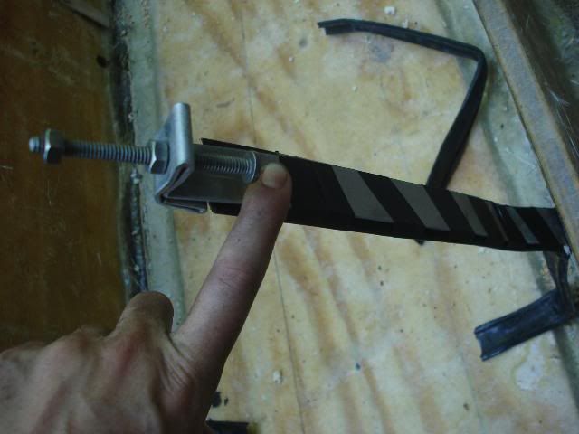

heres the original strap
Theres the one I made
