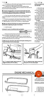

The flapper is in the upper section of the exhaust pipe, you would need to remove the upper elbow and rubber coupling. It's in a very similar location as my Ford 2.3.
All that was left on mine was the pin, the flapper had long since melted, I did find small pieces in the outdrive when I had removed it.

Ok. I have the riser and coupling hose off. I’ll look inside and see if it is there. I went through my manual a couple times and there was no mention of it. I looked for the part online and only found one listed for a Cobra not a stringer.
I’ll verify visually.
I check inside the exhaust outlet below the riser, this one does not have a flapper or any way of installing one. I wonder if stringers May have had something built into the intermediate housing?

Oh you have a stringer, the image was from my manual which was for a cobra.
I've never had a stringer but it may be the same or similar. It should be accessible somewhat easily either way, it should be higher in the exhaust system above the water line.
I'm not sure if I have anything about stringer drives, if I'm wrong I hope someone else can help.
