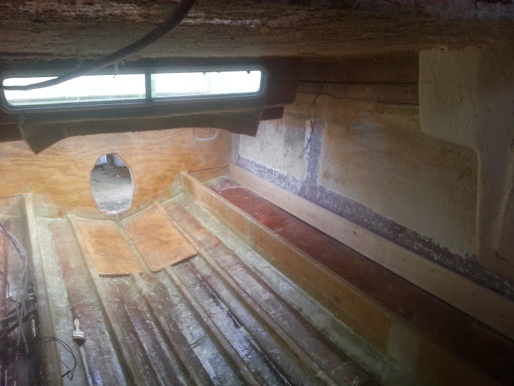

Finished the last layer of glass over the big stringers the other day, and then brought home a couple of 12' 2x6's from Lowes.
Today I cut them to length (with the requisite 15 degree angle at the transom end), and relieved the corners where it meets fillets. These run along the sides of the hull above the chines, and are what the sole sits on along the sides. The originals were 1x4 tabbed to the the hull with chopper strand. These will be significantly more substantial.
They are about 3/8" to 1/2" too high after being scribed to the hull. I'll strike a line along the top of them by laying a straightedge across the stringers then trim them for height before coating them in epoxy and bedding them in.
I also took one of the thru-hull fittings off the hull where the head used to be. This hull is 3/8" thick on the sides. what a tank!
