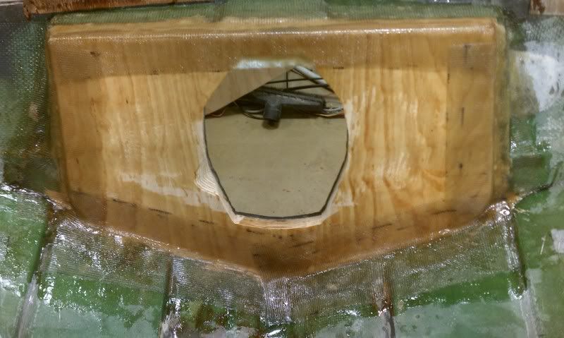

Just a short update from this weekend, I was able to tab in the transom with two layers of 1708 all the way around. I may have a few small air bubbles, but hopefully nothing serious. I plan on letting the resin cure and skinning the transom with two layers of 1708. Even though it may not be the best idea, I have some epoxy resin on order for the edges of the keyhole. Looking forward to bedding the stringers soon (off the hull, PB) and getting the deck on. Still lots of work to be done!

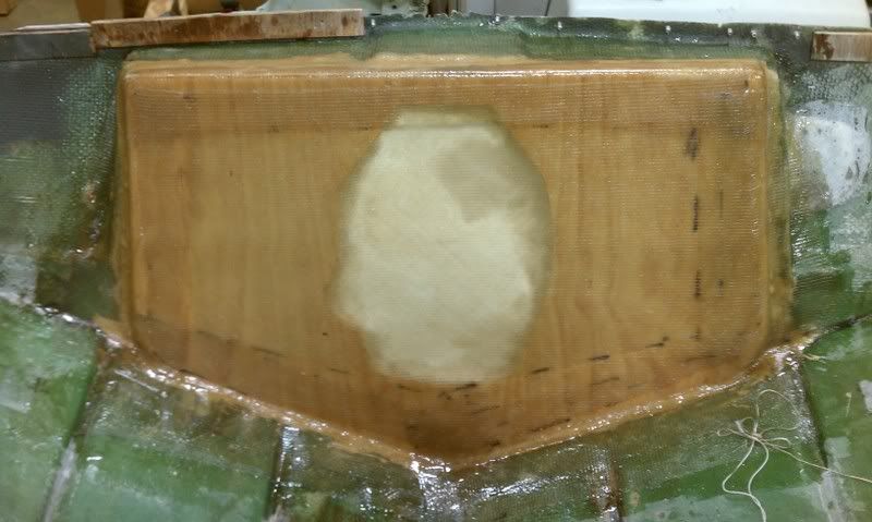

Re: 1983 Glastron X17 restoration
Thanks to everyone for the kind words and encouragement! I was able to skin the transom in two layers of 1708 tonight, I think it went pretty smoothly. My goal is to get the stingers bedded and at least partially fiberglassed in by the end of the weekend. Here is the latest pic:
Slowly but surely this project is moving towards splashdown!

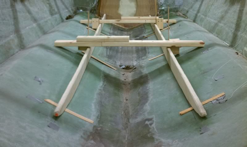

80
So today brought incremental progress. I was able to get the stringers shaped and dry fitted. I made a brace to hold the stringers in place, with shims used to keep the stringers from touching the hull:
Tomorrow I plan on making some PB and getting the stringers bedded. Slowly but surely, it is nice to be back at it!

jbcurt00
Oct 25, 2011
25,152
stringer setup looks good! & so the put back begins! Congrats!
