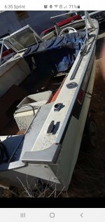

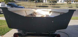

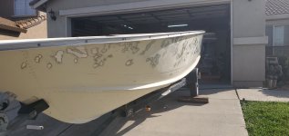

So i picked up a super cheap boat that i know needs alot of work but seems like a boat that will be great for the rivers and lake i go to. Started the tear down the first day and haven't stopped cleaning and prep work. Have questions and think alot of new boaters that come here will have ideas to play with . So here i go .
Paint: on a small boat theres alot of different paints around to choose from and the price not bad 90% of painting is prep work turns out great when time gets put in .
Floors: way are they riveted to the ribs? Why not use aluminum flat stock all the way around the boat and rivet it down to the ribs making a hard edge for your floors to sit on and use rivetnuts to screw down your floors . You could pull floors if you get a leak to run wires a whole world ideas If anyone out here trying this please do tell
I posted my work in progress and i mean work. Thanks for your time and pointers .

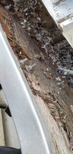

Oh boy that transom was mulch.
