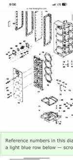

Ahh ok now what’s the purpose of the cover on the outside of the head? Doesn't looks like water or anything goes in it
