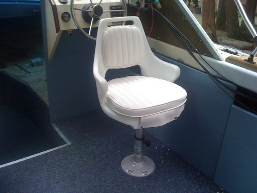

Rock,
Lov'in the captains chairs. Who's the manufacturer? I need a pair too!
Rockaholic
Seaman Apprentice
Jun 30, 2010
33
Re: 1984 Starcraft Islander Restoration
Rock,
Their made by Moeller, here is where I bought mine, cheapest price I could find.

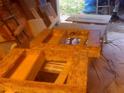

Splash Guard & Seat Box's
Another weekend of maybe next weekend :D
Made a replacement splash guard out of the scrap from the marine dug fur from the transom. Put some gun-stock stain on it, and a couple coats of west system, came out really nice.
Sanded down and stained/epoxied the trim pieces that hold it in place also.
Attached the seats to the pedestals measured and determined they would need 6inch boxes, which is also a good height to stand on and see over the front windshield if needed. Built two boxes and painted with fiberglass resign.
Still need to permanently attach the sidewalls, install boxes, carpet boxes, install seats, and finish carpet in the cabin.

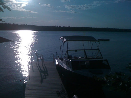

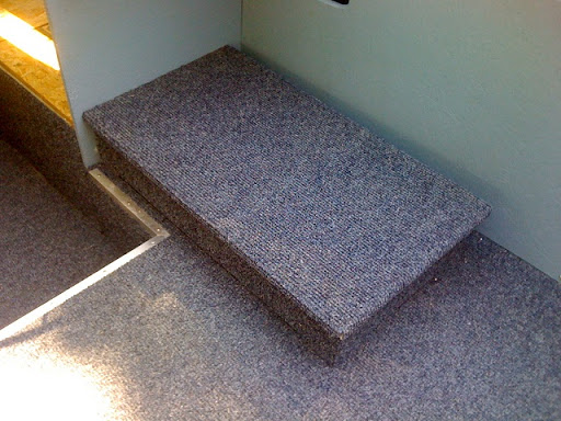

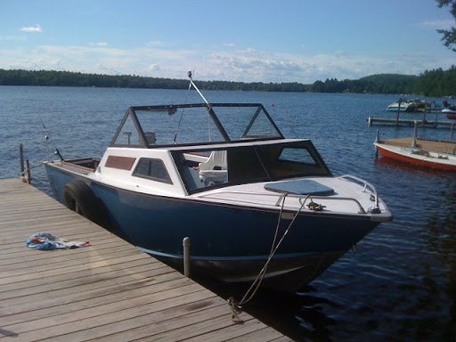

Seat bases and chairs are in, launched it for a test drive Saturday, was worried for a bit when it was taking on water due to the drain plug not seating properly.
Got the correct plug to seal up right and its nice and water tight now. Still needs carpet in the cabin, and a dozen other things. Cleaned up the Bimini top, washed the windows, looks pretty sharp on the water.
Does about 24mph down hill with the wind, but it cruises nice and handles the wake well.
